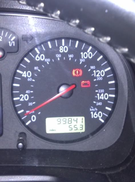

I was also hoping if someone could tell me about the clock onboard my speedo. It looks like it's failed completely as you can only see some of the display. I'll post a pic up shortly, but would I need to replace the full speedo unit to get this working again? Is it possible to even swap the speedo over?
Thanks for your time,
Conor.
Was hoping someone could tell me what has happened to my clock or if this is a common fault? Would the whole unit need replacing ?
This is the speedo issue I have my car reads 6/7mph when you turn it on even when I'm not in motion. Could this be anything do with the car being lowered or being in a shunt?

Also on the dials front do you think this is definetely the issue? I thought it was maybe that the LCD display had died.
#9 ·
I can only remember another instance of when I was driving the car home on the first night I got it the display cut out entirely but it was during that horrible winter blizzard period. Nothing like that has ever happened again, I think if I'm gonna be taking out the clocks then I'll upgrade the faces on them too with the silver dial bezzles
