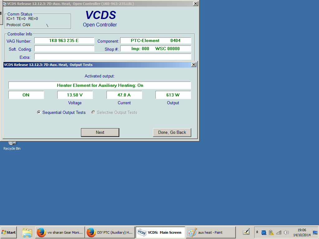

i didnt even know what one was so i have done some digging and found out what it is for so i have been doing some digging on vag com and now im confused

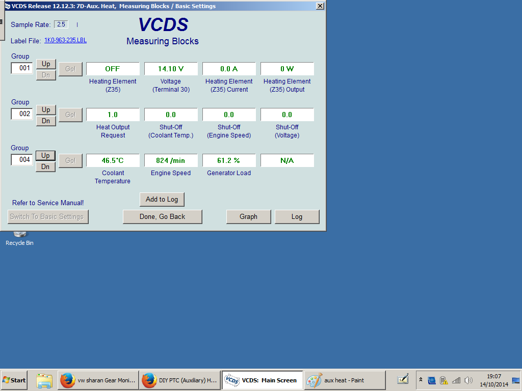

got nothing happening on the messuring blocks:
but did a output test and it did this

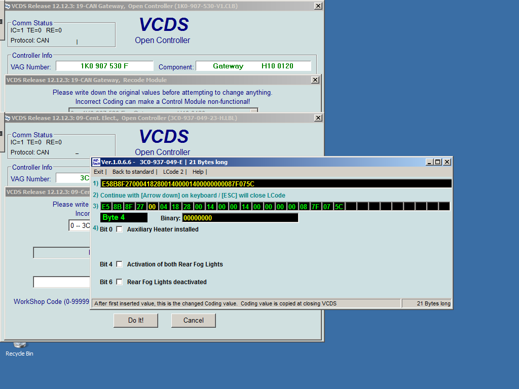

next i looked in the coding and found this
its ticked on in the can gateway
but not in the cent elect

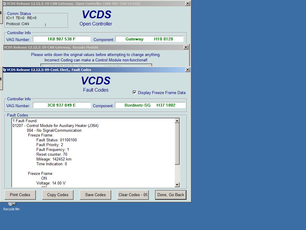

i did try turning it on but brought up another fault code
i am very confused can any one shed some light on this
