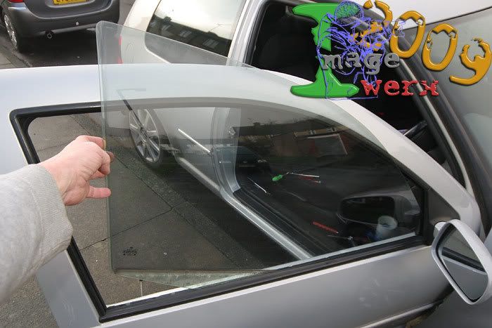

When you're actually doimg the work of replacing the mech,take the glass ALL the way out,there really is no advantage to leaving it in other than having to clean glue off the glass.It only takes seconds to lift it out but trust me it really does make the job a whole lot easier......
