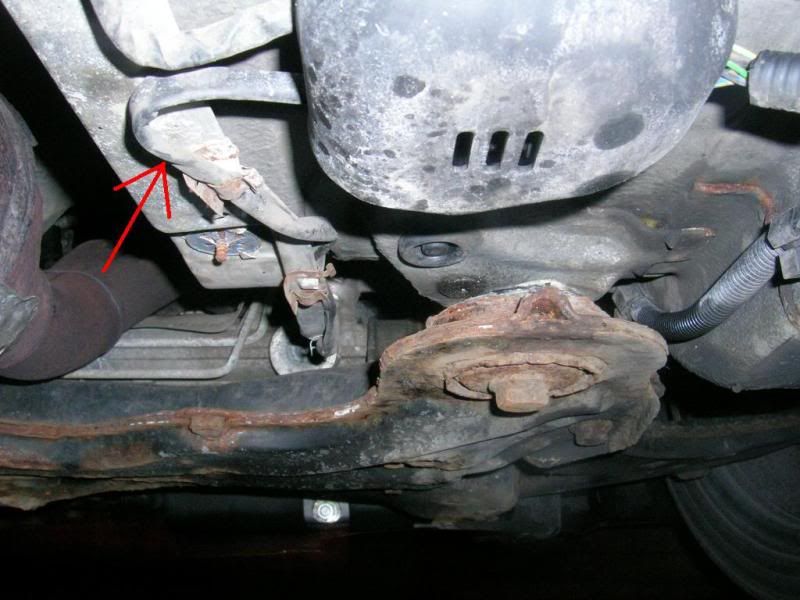

Hi
Anybody know what wire this is?
Photo is looking towards the front of the car.
Has this got anything to do with rear the ABS? How is the rear ABS wires routed in VW golf/Bora?

The rear ABS sensor wires go into the car through the wheel arch and then inside the car to the engine bay.Not sure about that wire though,the only other things under the car that would have wires going to them are the lambda sensors.
Chris.

the wire is for the lambda sensor, inside that box is where youd unplug it if you were to change it.
