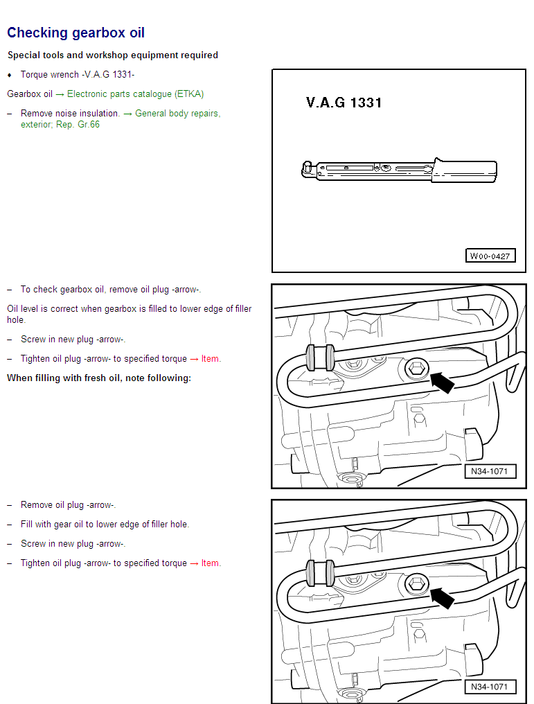

02M is the transmission, do you know your gearbox code? it will be on the data sticker in the boot. If your car is a six speed it should be the same oil as mine which is an 02M ERF gearbox [y]

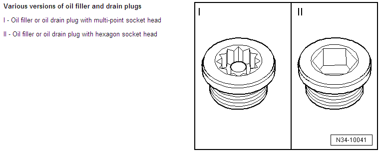

There are two types of filler plugs fitted to the Golf not sure which one you will have:
Here is the VW guide for checking the level
You can see the drain plug in the pictures on the bottom of the box [y]
