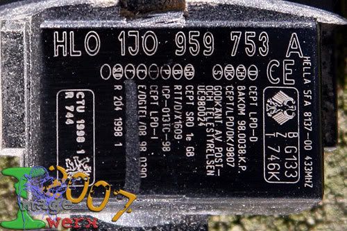

Have a read of the Key FAQ linked in my sig it will show you where to look[y]

That is a picture like in the FAQ showing the info on the rear of the key's top half
Sorry but just read the original post again,your car MIGHT not have remote locking (although it could have).If it does have,all the original keys with the exception of the plastic one would have been remotes.
You need to get to the CCM that's behind two lots of panels in front of the drivers legs and get a part number off it,this will tell you whethert it is remote or not and if so what frequency it's on.
