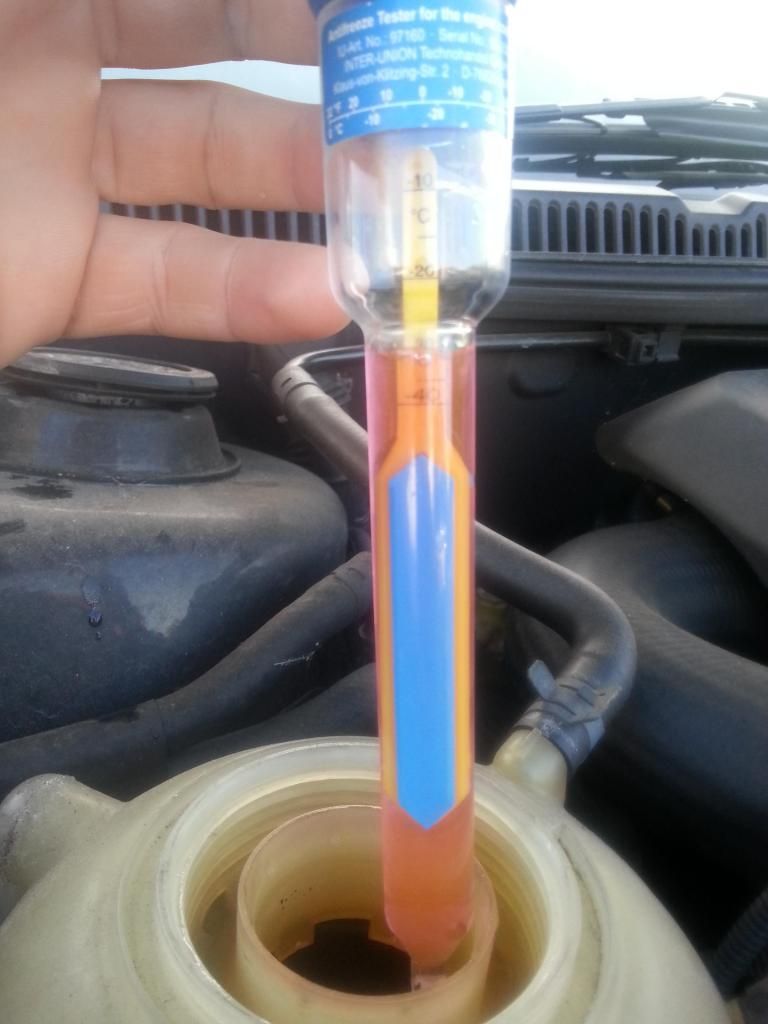

Just checked my coolant and it looks to be the pinky type. Tested it with a coolant tester and it says just below -30(so -35ish) but doesn't say up what degrees here is a pic as i don't understand it hope someone else does....My coolant is just above the minimum mark, would it be okay to top up to the middle until i get some g13 or the comma g30 antifreeze while weekend then ill top it up to the max mark with the coolant at weekned.
