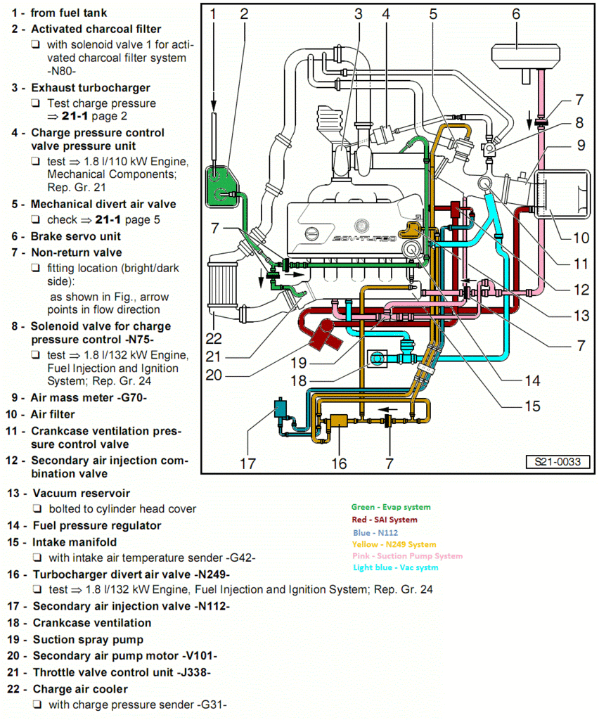

trying to locate the purge control valve and the air pump? mk4 golf

i need to locate there position if asny one can help?

this should help
