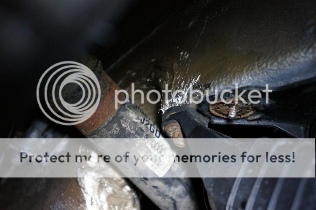

Thanks guys glad you like it, That's a pic o the sump guard I bought off ebay after burstin my sump [:$} haha

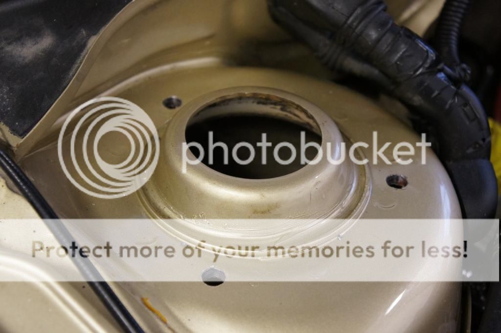

The moment you've all been waiting for Airlift auto pilot v2, expensive kit but worth every penny id say the basic kit started at ÂŁ1700 and would have been a ÂŁ1000 to upgrade to this so and I new id regret it so went all out and got the fancy 1.
Hope u like?
Rear bag built up ready to fit.
Rear bags fitted also fitted bilstein rear shocks to as iv herd they are best with this kit. Thought id upgrade the brakes to, new calipers pads and discs and a lick of paint.

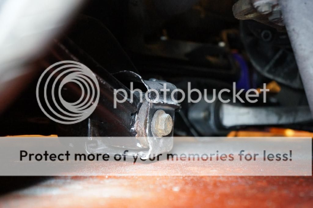

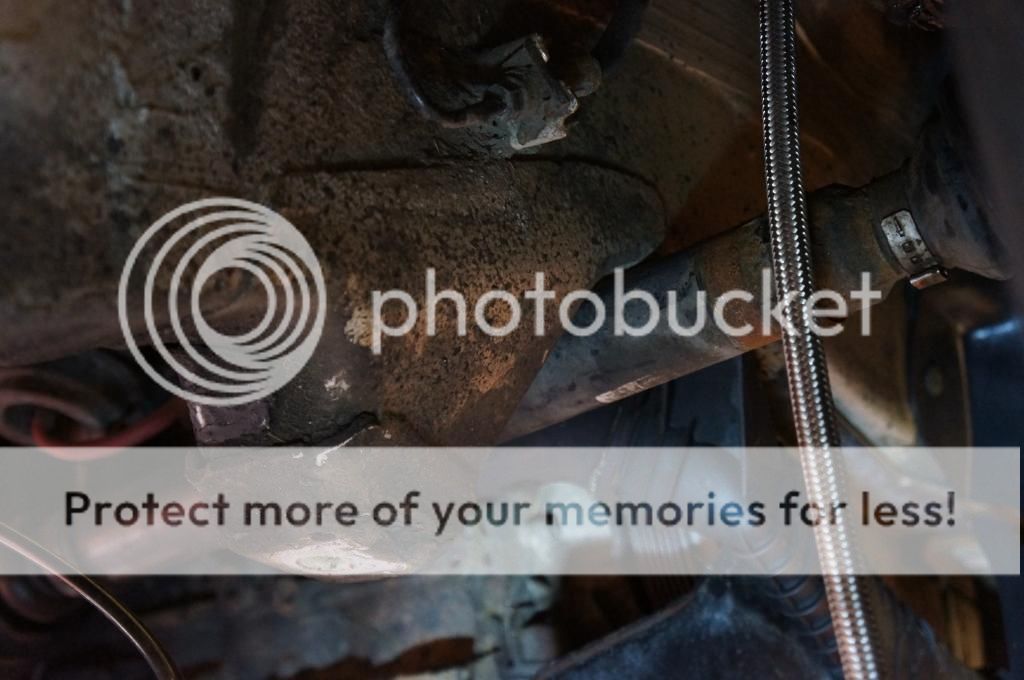

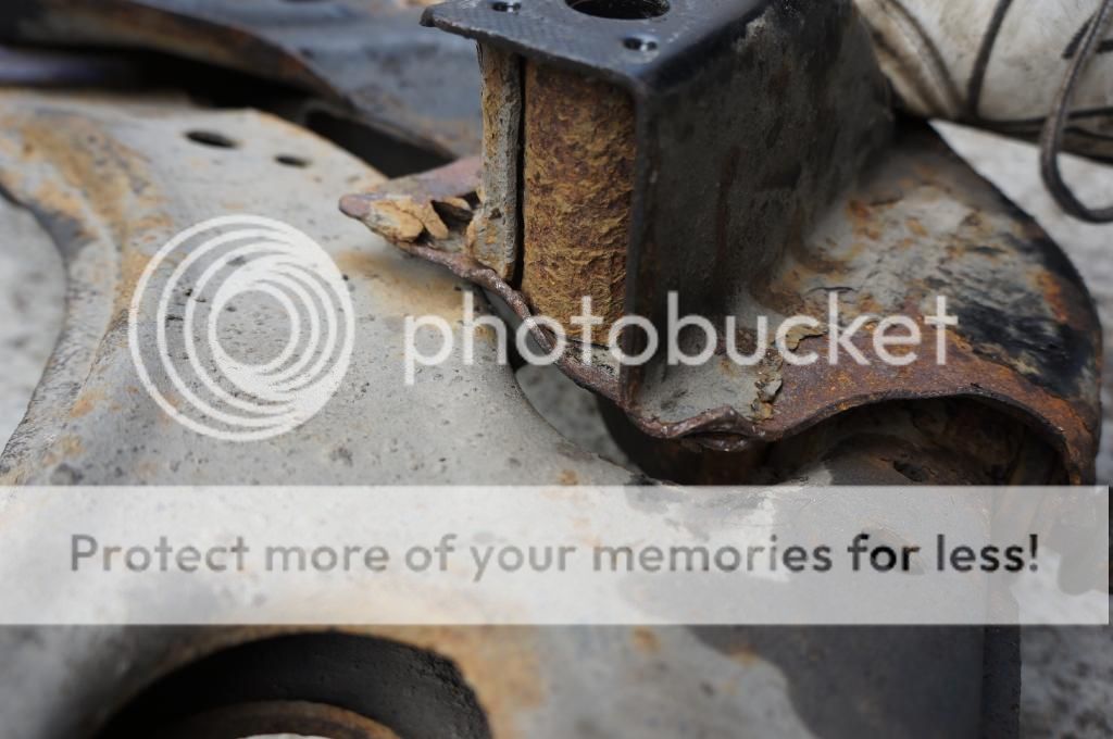

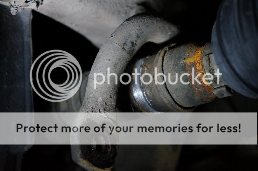

As you can see the car has be fairly low, subframe taking it hard, also its getting a bit rusty looking. So i removed it as I had to for a new steering rack. Plus easyer for removing the ARB.
A bit of trimming and it can now let the car sit lower.
Thought id shot blast and paint the sub frame and wishbones wile they where off, poly bushed the sub frame to and did the steering rack as it was off so now the car is fully poly bushed. Except the engine mounts, I did try a poly bushed dog bone mount but thought it was to much shuddering for my diesel, Ok on your petrol but a TDI

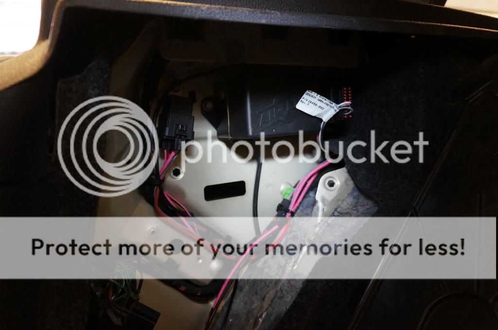

A pic or 2 of the plumbing in, it was real easy 3 wires, + - and a ignition, all in a loom sealed plugs for the relay and manifold all simple plug and play.

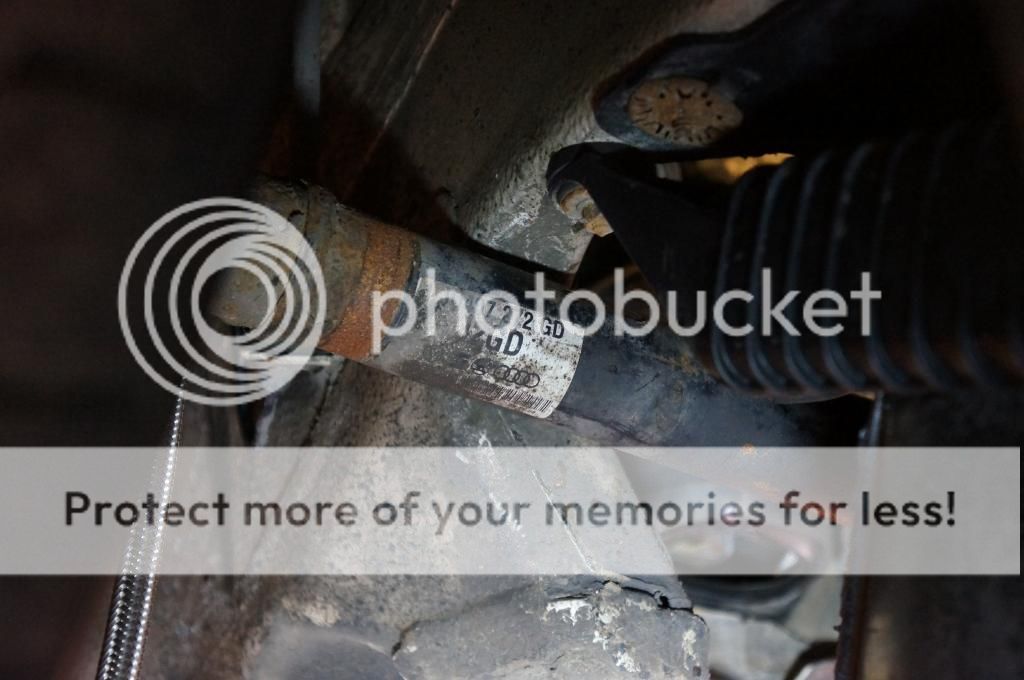

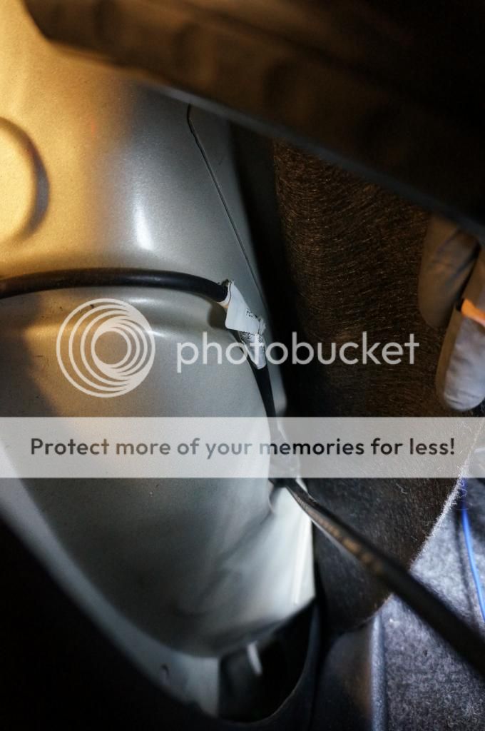

Rear bag pipes I ran in through a grommet for the rear abs wire I think it was.

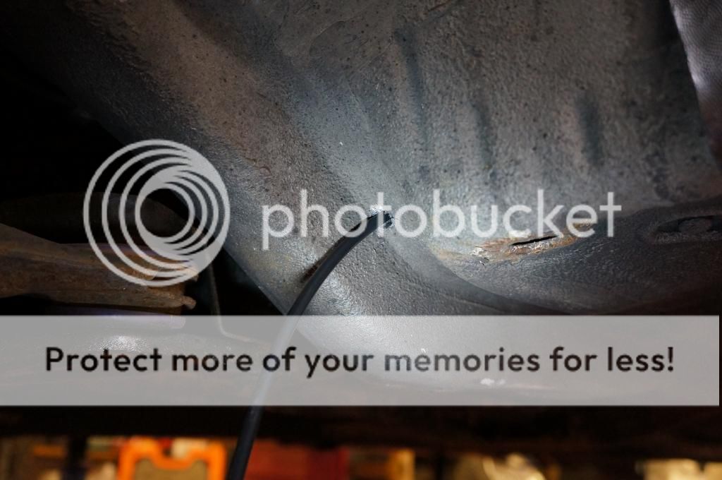

Front as far as I could see on other peoples air installs this was the easiest way. Now after having fitted air ride I would have done it a different way.

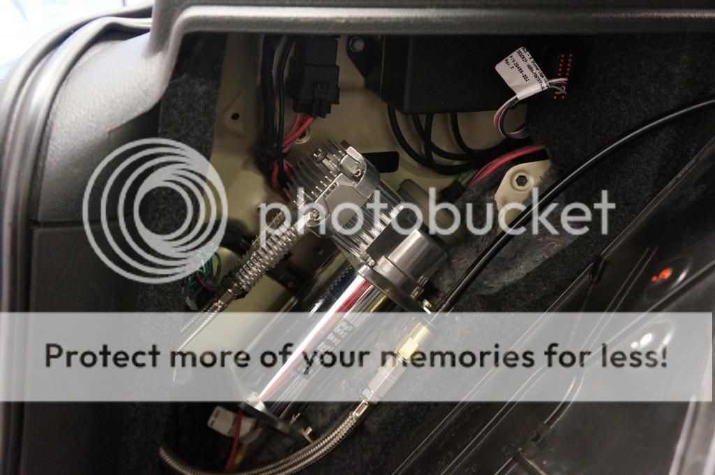

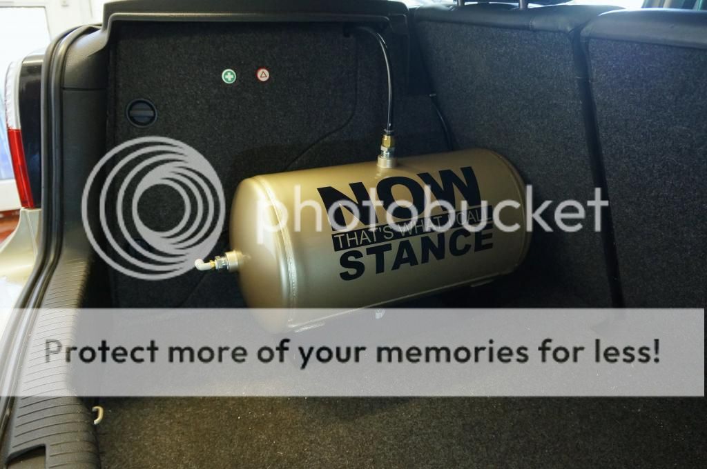

Was chuffed with this got its all fitted nicely in the rear cubby hole in the boot so I could keep my spare wheel.

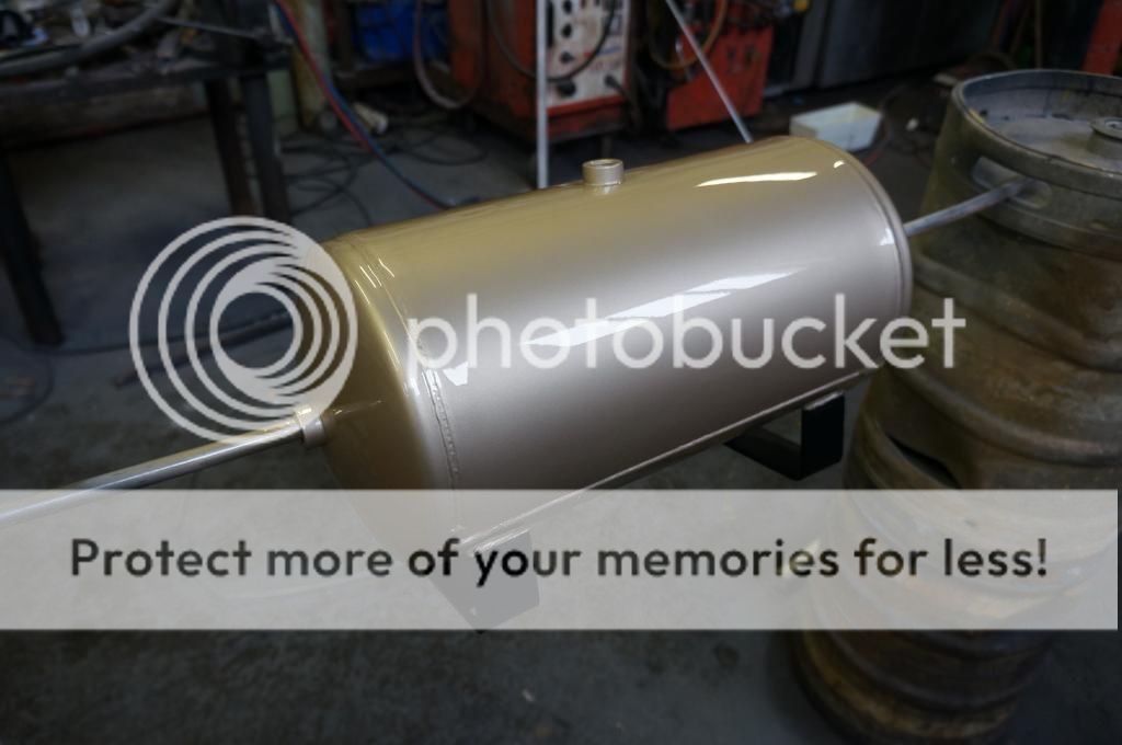

Now iv seen some real cool tank ideas, but I had no idea what to do just didn't want the standard bumpy black it was painted with so after a fue hours priming and rubbing down got a nice finish and painted it same colour as the car for a start.
Well got it fitted out the way as much as I could, and just added a sticker as I had no idea what to do with it.

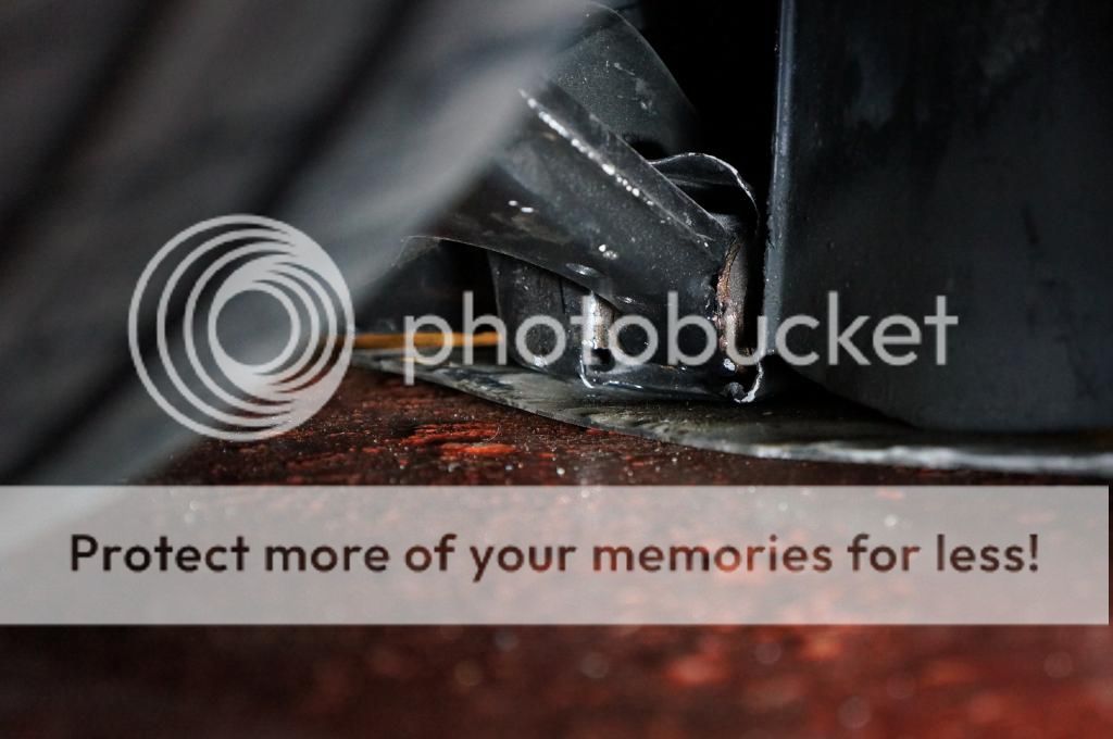

Sorry for being so pic heavy, but thought I best put these ones up because its chassis notch time.

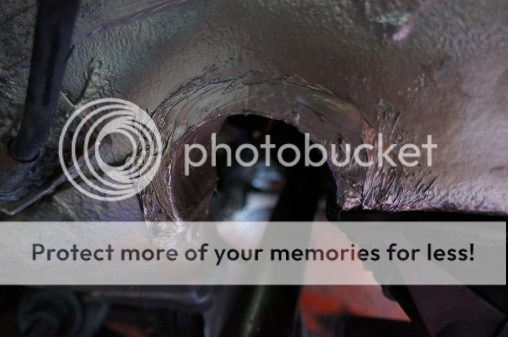

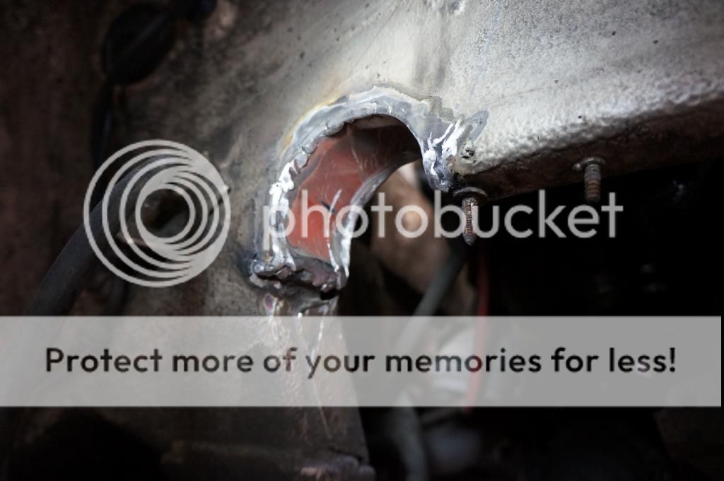

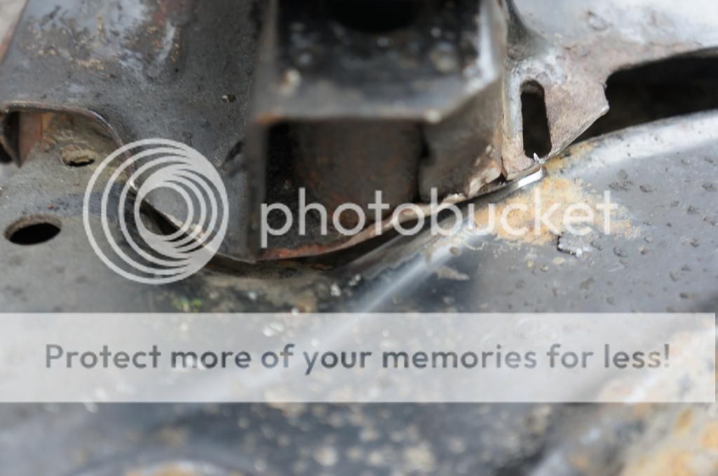

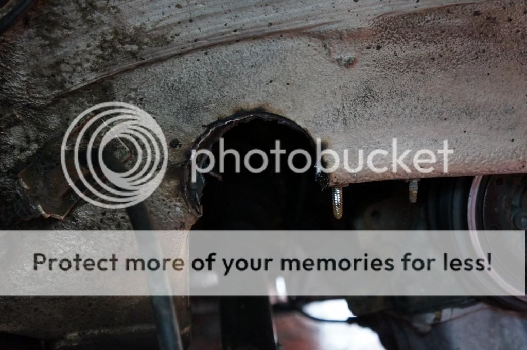

N/s was fine when aired out, but O/s needed a notch.

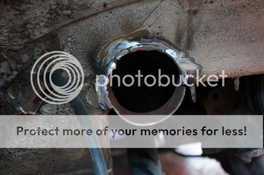

Didn't go for the hole saw method I tried the plasma cutter and worked nicely id say.
I cant mind but think it was a 85mm bit o steel pipe I welded in, and I know the welding is not the best. haha
Worked ok I think.

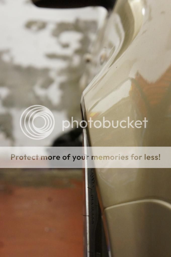

Now that allowed the car to drop and sit pretty like this.
Nice and low.
Notch finished should be ok.
With alloy pan on its hard on the deck.
