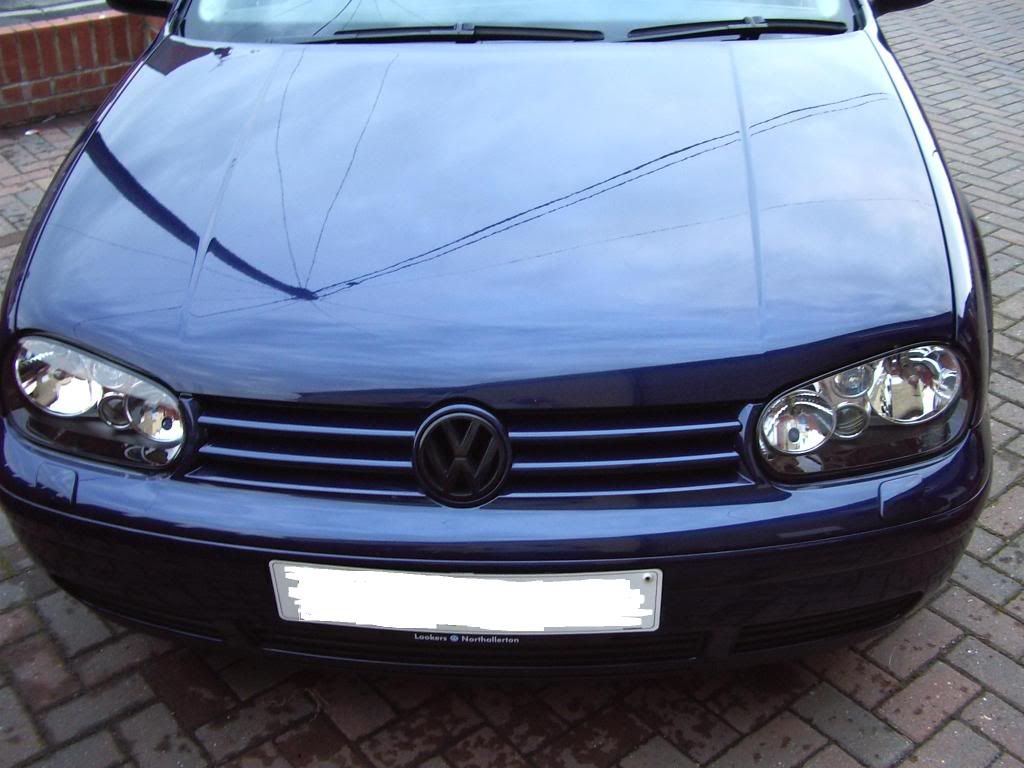

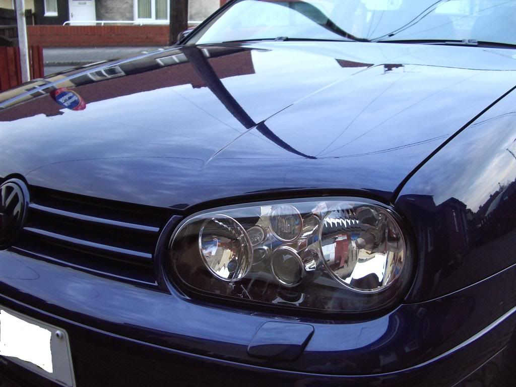

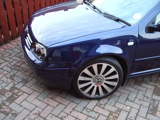

I still cant manage to get the swirls out?????
I used poorboys shampoo
sonus claybar and poorboys qd
PC with ssr3
PC with ssr2
poorboys shampoo again
Klasse all in one
Klasse sealant glaze
Harley wax
Looks a little shinier, but nothing is touching the scratches and swirls[:'(]

Ok then, I bought a 3.5" backing plate and 4" orange and white pads of alex, then got some mazerna power gloss and intensive polish. I concentrated mainly on the rear quarter panel, which had major swirl marks, a few 12" scratches, and the dulling that I did last week!
I spent about 2 hrs on the panel, did a few passes with the pad, and a few compoiund applications (4" pads seem a lot harder to work with)
the end result was that I got rid of the scratches, the dulling, and the swirl marks are hardly noticeable, really small and fine now, a vast improvement[:D]
I tried a different panel, but by this time the orange pad was caked with the compound, and I didnt seem to be getting any results, so looks like 1 panel at a time after the pad has been washed.
I recommend anyone that has had the same problems as me with a pc to invest in smaller pads, and some mazerna stuff. Might try the ssr's that I have next time, just had to give the new stuff a go!
