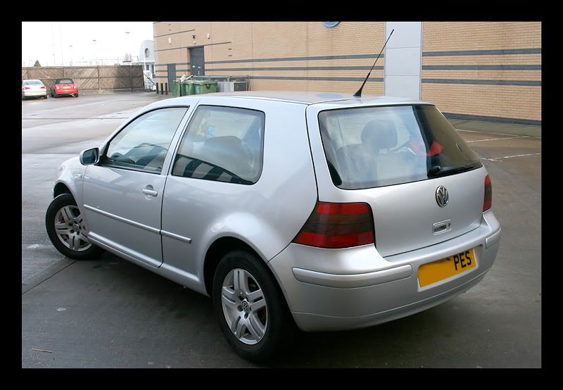

I've had my TDi 'PES' since October but I've been a dubber for a good few years since buying my first which was a MK2 gti 8v. I have always wanted a MK4 because in my humble opinion they are the best looking. Due to the fact I commute over 500 miles a week there was no option but to have a TDi. My budget sadly didn't allow for the 130 so I decided the 110 would suit my needs. I wanted eithe rblack or silver so when PES came along I parted with the readies and had what can only be described as a lovely drive home.
Anyways the humble spec is it's a 2001 MK4 GT TDi 110 with the 'newer' ASV engine in reflex silver. 132K on the clock and totally un-molested which is excellent.
All I have done so far is replace the MAF as there was a little limp mode issue. Then I replaced the temp sensor for the newer green one.
Things I want to do so far is obviously lower it and get some tidy wheels. I need to sort the doors as they are a little out of line. The glove box needs a new flap also. Carbon fibre bonnet and a maybe little tasteful carbon fibre here and there. Then once a trip to this years edition38 has been done I'm sure all of this will change as I soak up some new ideas
Anyways here are some pics, like I say all standard still so a nice blank canvas to work with. [^^] Watch this space....... [:)]
