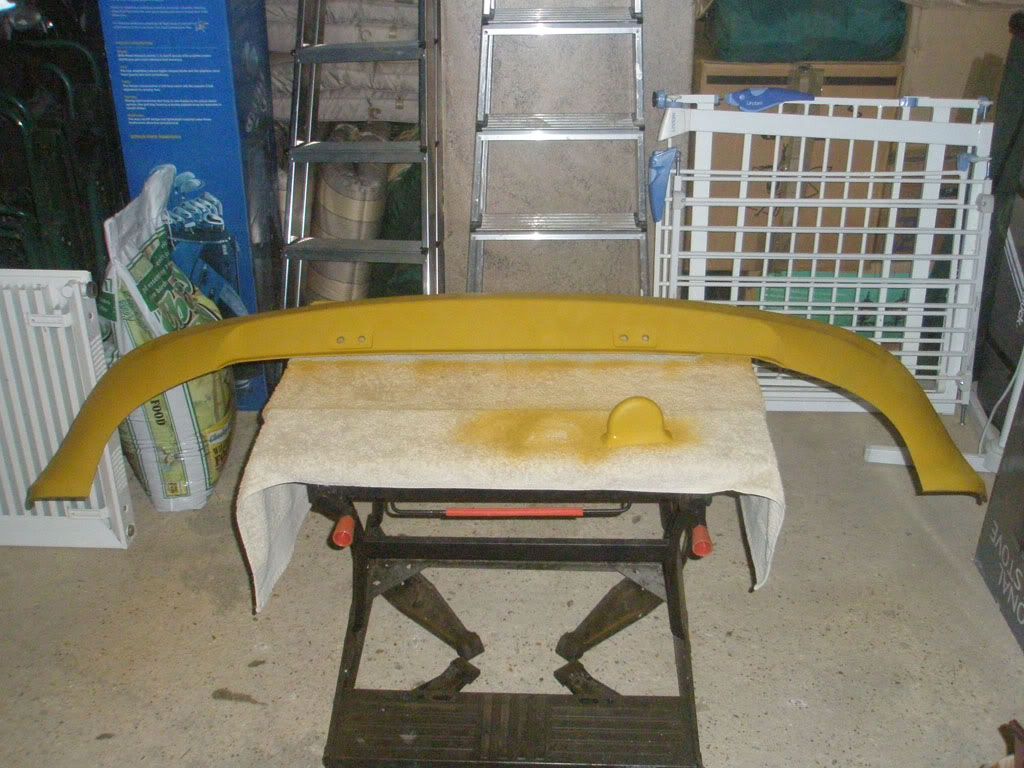

Right after sanding the rear valance with some 80 grade sandpaper I have now sprayed it with some filler primer. As far as I'm aware this stuff fills scuffs and scratches better than normal primer. I've done three coats of filler primer and now have to wait for it to harden, so I'm going to leave it overnight, before using 600, 800 and 1200 grade wet and dry to get the smooth finish I need before primer and then paint.

your gonna have a mare getting rid of those scratches fella im telling ya! its all in the prep, any area your going to spray needs to be relatively smooth. 80 grit will not do this. Filling the gaps with filler primer is not the correct way of doing it, its just going to make your life more difficult in the long run. those lines scratches you see in the last picture will show through on the paint even if you fill it with filler primer. i would say 600 grit the highest before you start applying primer. then start rubbing down with ya 800s 1000s. once you got a few layers of paint on then attack it with the 1200s 1500s and lots of soapy water. get it mental smooth and paint with at least 3 or 4 layer of paint min!!
Paint shops may do it different as they have the right tools, but said method i mentioned above has never let me down as DIY. im no sprayer but i know hands down that your gonna have a mare with all those scratches in the valance all ready. been there, done that, learned my lesson.... thick layers of paint/primer never solve or hide nothing.
If you haven't used either plastic primer or adhesion promotor that lot will flake off once it's fully hardened.As Gman said 80 grit is waaaaaaaaaaaayyyyyyyy too coarse for prepping a surface like that unless you do every single square mm with it,then the same with say 180 grit,then 400,then 600 and so and so on.......
You'll never fill scratches that deep with filler primer from an aerosol can,even iff you do it'll be so thick it'll crack the first time it flexes.You need the plastic to be as smooth as possible (600 grit smooth or better),then plastic primer it,then a few light coats of normal or filler primer and finally the topcoat.
The problem with soft plastic like that is that where the scratches are it forms into whiskers that always show through the primer no matter how much you put on,you MUST get rid of those before you go any further.

I have already said that I will be sanding this down with 600, 800 and 1200 wet and dry before I spray it with anything else. Then once I'm happy I will spray with primer and then sand again with 1200 to get it even smoother. I'm using a guide I found on this site and this is no where near finished and I know that.
This is a spare valance I had so there is no rush to get it back on the car and if I ain't happy I will continue sanding until I am.
Cheers for your advice tho [Y]
But you still can't put normal primer straight on top of plastic,it won't stick properly.
This is the guide I am using. I'm not sticking religiously to it tho. The yellow you see on the valance is filler primer. Is that not similar to plastic primer?
The plan is to sand that till I get it nice and smooth and then I will be using plastic primer before the paint goes on.
No filler primer isn't the same as plastic primer,hence the reason for giving them different names[:p].The plastic primer or even better this stuff MUST be the very first thing you put on the bare plastic........

What will happen if I do what I said then? Sand down till smooth, primer then paint?
As the guide I have looked at used this method and the pics of the guys valances look good.
How about if I sanded it all smooth as it is and then use plastic primer as I'm sure most of the filler primer will come off as I smooth it more?

You need to sand it as smooth as possible to get all the filler primer out of the relatively deep rubbing down marks,or if you leave it for a while it'll almost certainlly peel off by itself.Once you've got the surface properrly prepared (over prepping can be as bad as under prepping) then you can use filler primer in moderation,the problem will be the quality of aerosol paints which are a lot more likely to crack than "proper" primer applied ffrom a spray gun.
Chris.<o:p></o:p>
Ok mate cheers. I'm not greatly fussed about long term as I will hopefully find an anni valance already in reflex. Another reason why I got a spare valance to do it on to. If it goes tits up I can always stick my other one back on. Cheers again [:)]
