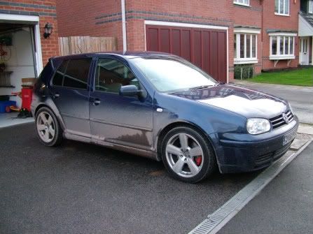

I wouldn't be without one, when a car is really dirty you can't get it clean with a hose and wash mit even using the two bucket method without scratching.
An extreme example but
Even after a blast with a hose you will be left with loads of dirt on the car which in effect becomes sand paper when you use the mitt [:(]
But soak with foam to "wet" the dirt for 5 to 10 mins
then blast of with the PW and you get this
Which is then ready for the two bucket method [y]
Also if you are getting paint off with the PW then you are getting it too close, there is no need to get it less than 12" to the car and then it is always at an angle and never square on.

N07, what foam did you use to get it that clean?
What powerwashers do you lot use? as they range in price and power etc...
I have the Autobrite snow foam lance together with their own snow foam, I mix a little shampoo in with the foam too [y]
The p\w I have is a Nilfisk similar to this
The car looks cleaner than it actually was, the dirt comes off well if the car is waxed but you still need to wash with a mitt, as I said earlier it is great for loosening the heavy soiling to prevent swirling when washing after

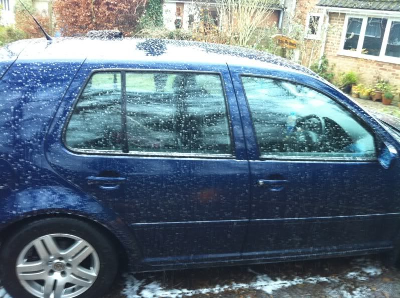

This is what i get just using cheapo halfords detergent in the detergent bottle.
And after a wash with turtlewax and the mitt
not bad considering it's not been washed in about 3 months/4000 miles.
