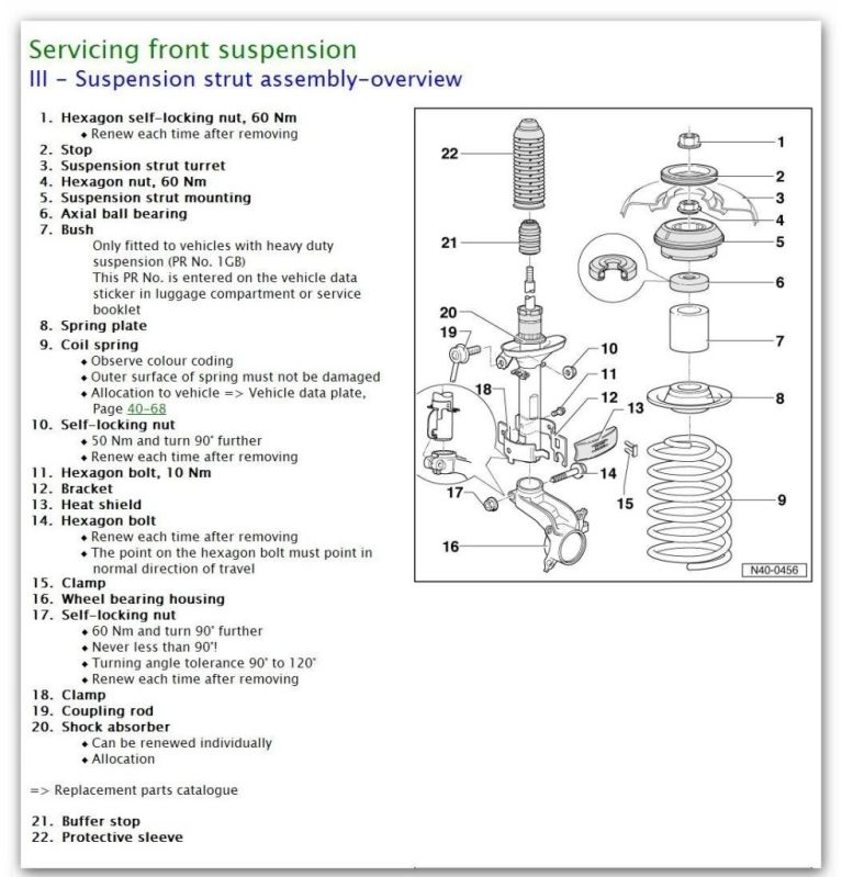

Hi, which strut parts do I need to replace, I've herd of the bearings and something else, I'm going to change the rear as well so any advice would be perfect.
I've added a pic
thanks
