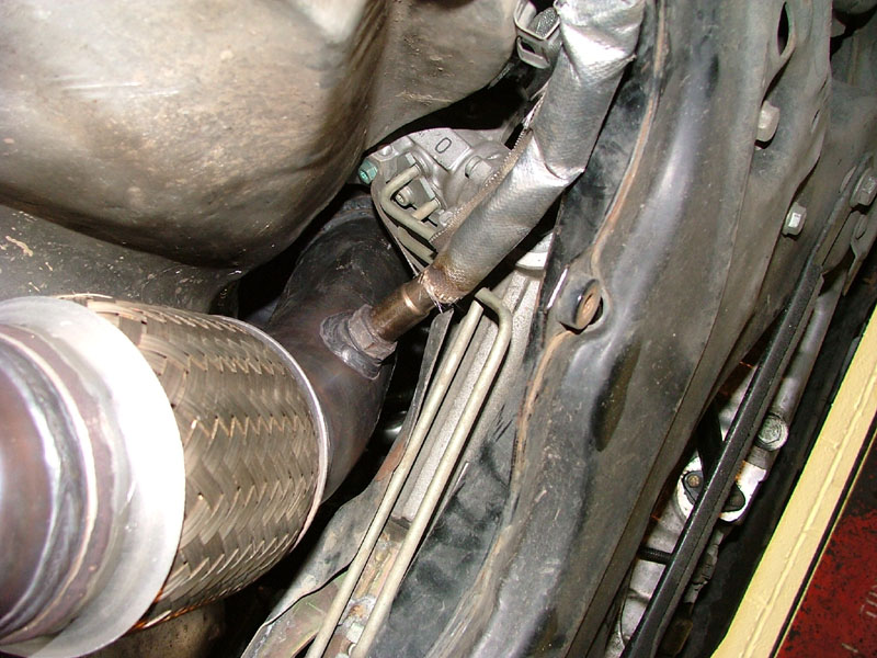

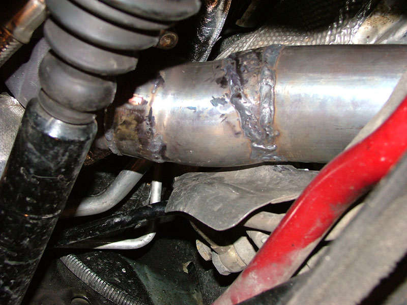

Anyway, the kit eventually went on thanks to the determination of Kev and James. I went up to fetch the car the following Monday. I arrived mid afternoon, to see James fabricating the downpipe. Cast iron down pipe adapter welded to stainless steel down pipe. This is not the prettiest of solutions, but there wasn?t really a lot of choice given the parts supplied. JBS are currently having a full stainless steel down pipe made for me to replace the cast turbo outlet, which should be much neater.

Downpipe close to steering rack

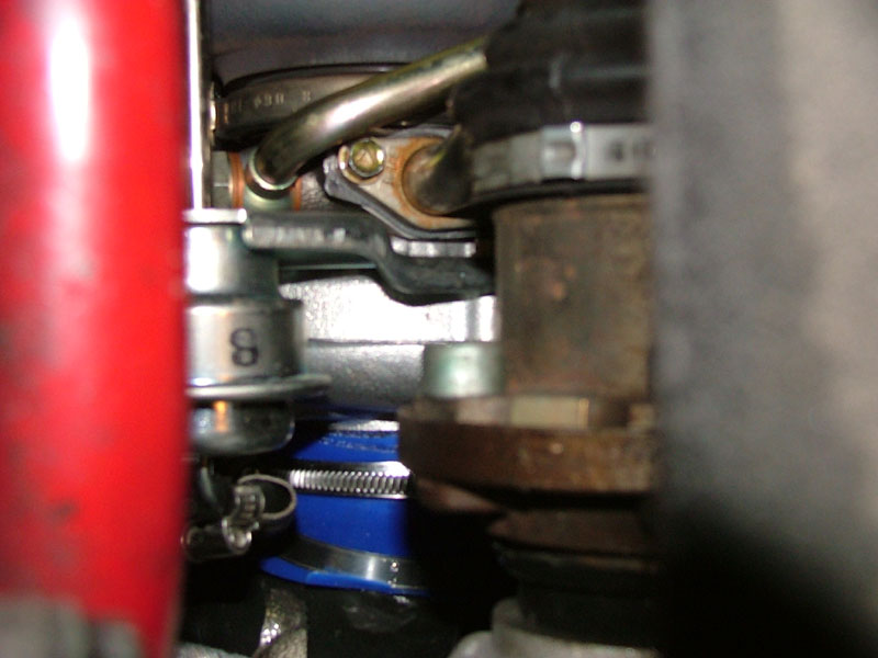

Turbo inlet
Downpipe close to steering rack and driveshaft.

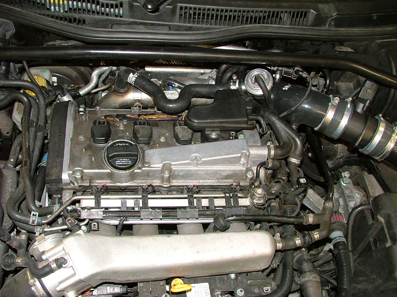

Looks pretty standard up here doesn't it.

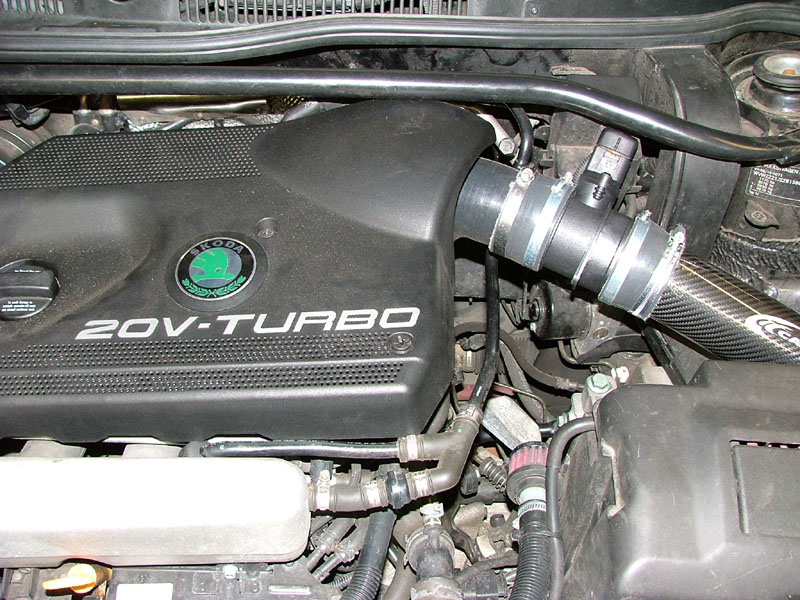

One for the skoda boys
