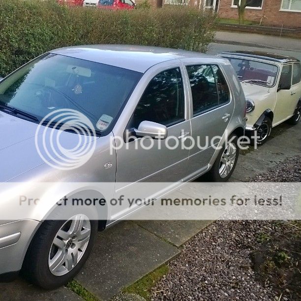

Brought my golf to be a sensible economical daily as I have a 60 mile commute and it was starting to be a bit of a struggle for my 1979 classic mini! The plan was to simply buy and look after the golf as well as possible so the mini could be my weekend toy. That quickly changed (after about a day) when I realised I couldn't have a car without having the occasional tinker! So I now had 2 projects on the go!
Its an 03 plate 1.9 tdi pd golf match 100hp with 92000 on the clock. no service history but did have old mots and drove right and ran right. all details checked out hpi clear ect so I brought it.
It needed cam belt doing and a clutch which enabled me to get the price down a bit so I was happy.

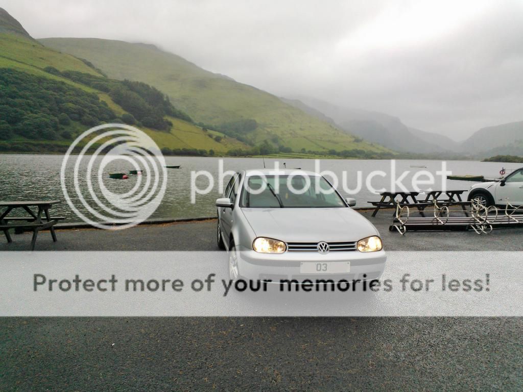

This is on a typical summers day in wales

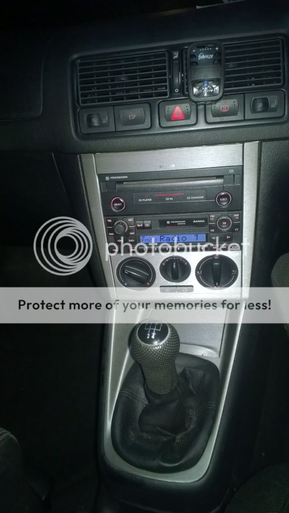

Next job was to have a go at tidying up the interior. It wasn't really in bad condition but the rubber coating on door handles and the centre console was starting to wear away and look a bit tatty. Id seen a few threads about wrapping parts and seen a lot of carbon fibre. I also like the look of the silver r32 parts but the prices of second hand stuff did seem a little high. I decided to have a go at wrapping it all in brushed steel vinyl. Some parts did take several attempts but I'm very happy with the results
Here is how it was (not my car and wheel is on wrong side but you get the idea)
vw-golf_1998_interior_1024_zps39afadc1.j
Here's the results.

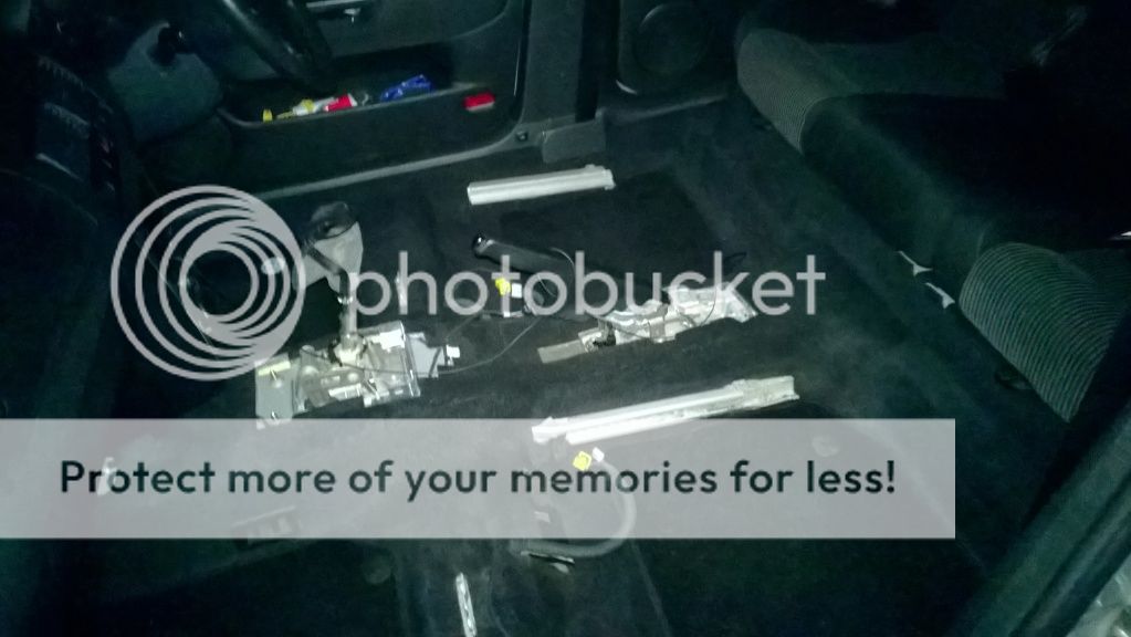

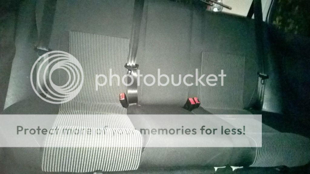

And the big one: GTI heated cloth sports seats :), very comfy, much more supportive in excellent clean condition and of course heaters! Rear seat has the 3 proper seat belts and 3 head rests to replace my standard rear bench with a centre lap belt. Almost feel guilty as the old seats were/ are in very good condition. Gave the car a very thorough clean whilst seats were out.
Both the fogs and the seats use kufatec looms which were dead easy to fit and seem excellent quality.

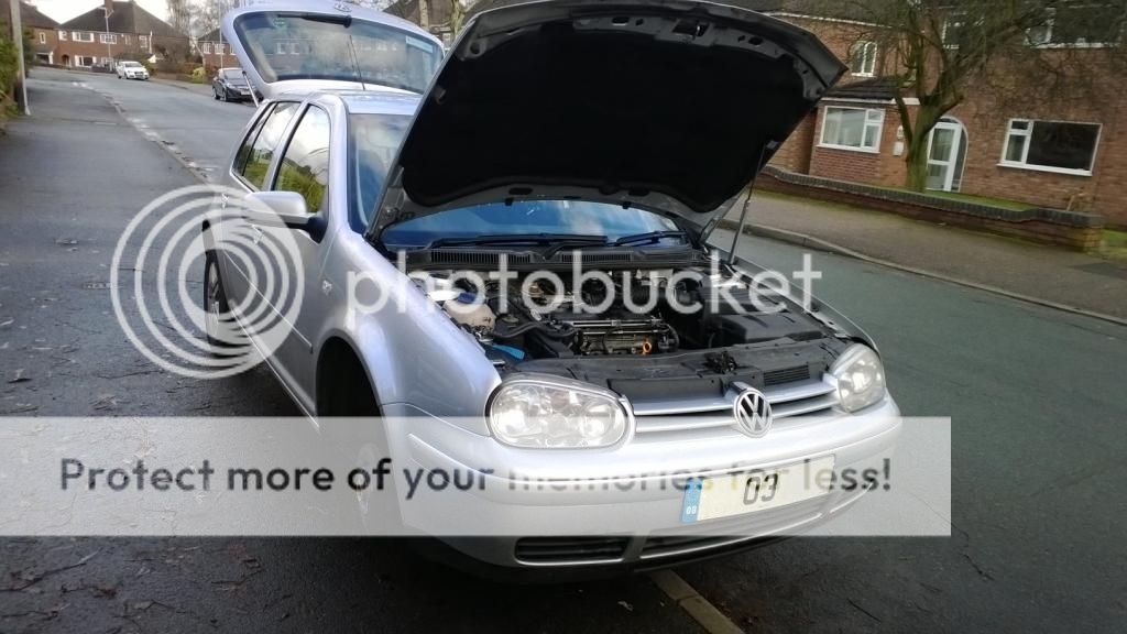

remap possibly with a 130 turbo and pipework upgrade (will get mapped first and then decide!)

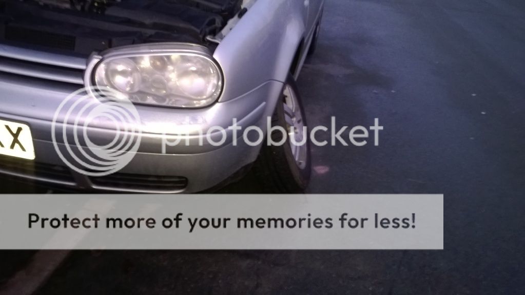

Got my euro lights today:
before
during
after, not the best pic as it was nearly dark and if I put the flash on just got reflection of the rear reflectors and regplate!
And one showing off the twin rear fog mod I did a while back.

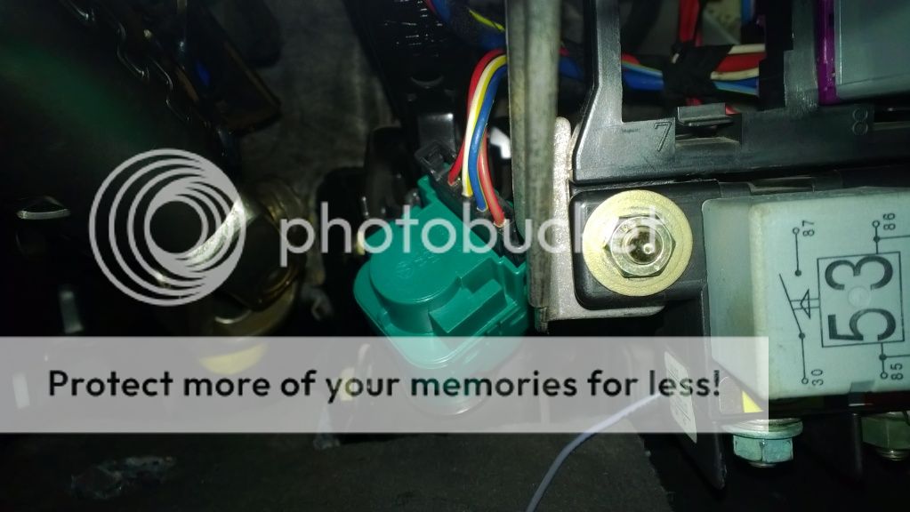

had a problem with the brake switch on Tuesday evening, dashboard lit up like a Christmas tree and engine workshop on screen no brake lghts. scanned on vagcom and got a brake switch fault and a abs sensor fault. turns out the abs one is brought up by the brake switch fault so £13 and a trip to vw later problem fixed and error code free once again :)
