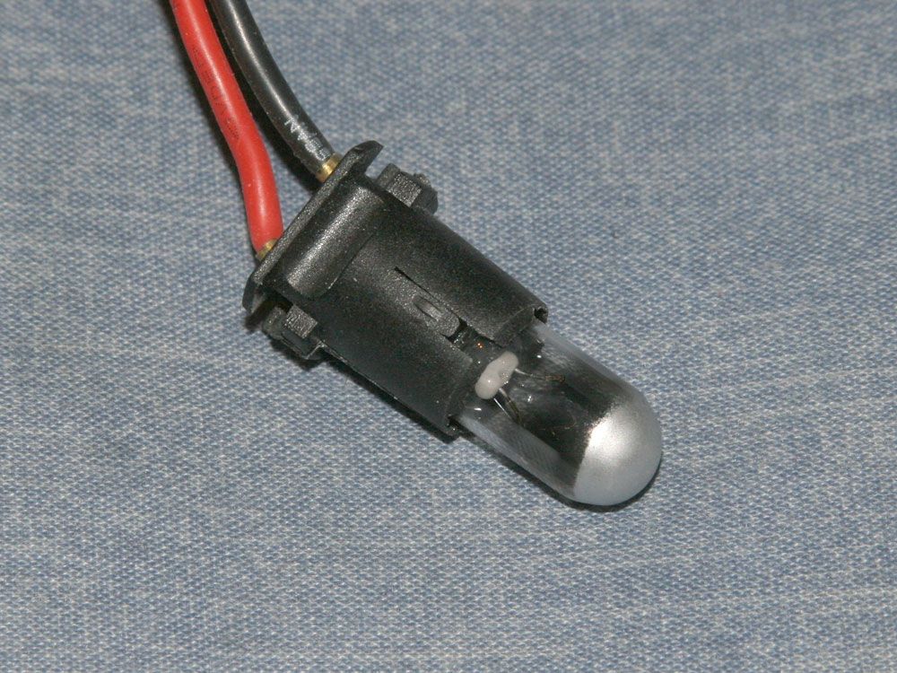

On the passenger headlight, the rings dont work due to the bulbs are all blown!!
Does anyone know what these bulbs are? I have never seen them in my life!! They are very small, and there are about 5 or 6 on the large rings and 4 or 5 on the smaller rings.

The old Depos I'm rebuilding have 4 X 501s like this with the tip painted out to stop bright spots......
These ones are just a not-too-tight push fit,pull out and push back in again.
Chris.
501 / W5W Wedge (Push in) Fitment bulbs mate
my ones are much smaller than standard 501s

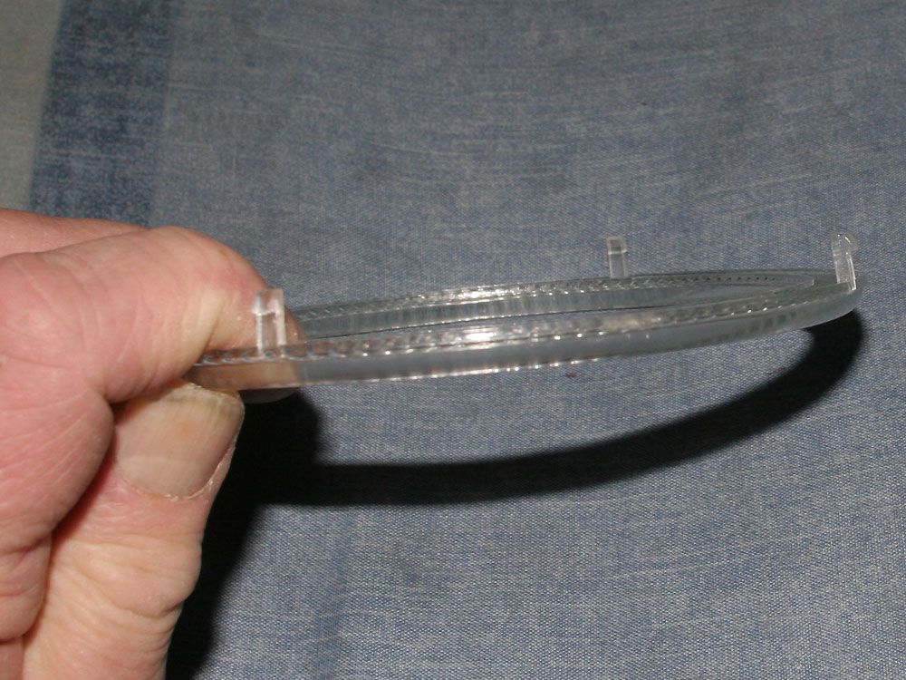

Once the lens is off they're held in by these four little tabs,easier to release from the back though...
Chris.
