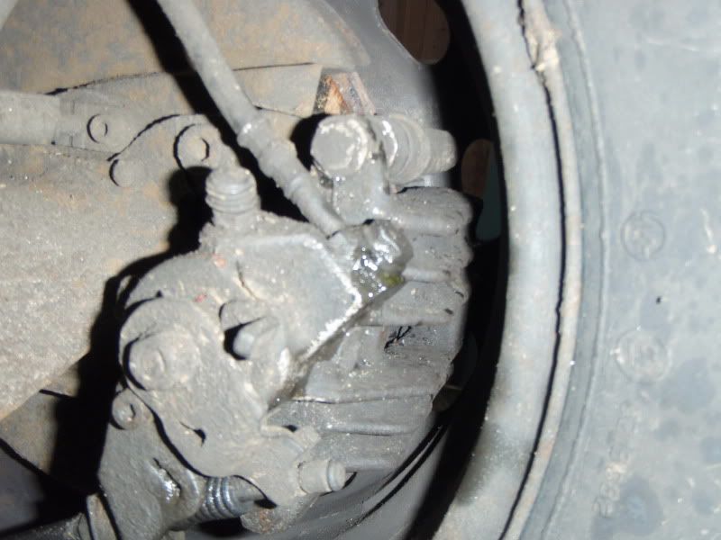

Just fixed my alternator and got my front valence fixed back on when i noticed the back right brake caliper was leaking!! Going to get some more fluid tomorrow morning to stop it running dry, then to take the wheel off for a better look.
Such a bitch after i've just fixed one problem, but any ideas what it could be thats leaking exactly? Thought you lot would be best to ask about any common problems.

Take the wheel off and see where it is leaking from first.
You should be able to do it with the help of a haynes.
Cleaned it up and had a good look. It's definitely leaking where the brake pipe goes into the caliper, looks like an 11mm bolt going into a square fitting. Tried using the search bar to find people who have done this job before but got 3 pages in and not a lot.
I'm guessing this is where the aly washer is, just hope the stealers have it in stock.

Just a bit leaking out... been down the stealers and ordered in the part. Apparently the flexi hose comes attached, any decent guide on fitting the flexi pipe? Not sure if i need to totally bleed the system then do it or do it with the system full?
Bought myself an eezibleed to make it a bit easier too.
Brad
you will need to bleed the corner that you work on, a good tip is when you have the car jacked up and wheel off put a bar on the brake pedal as to hold it down - will stop it bleeding out and having to bleed the abs unit. replacing the flexi is easy enough just undo it at both ends (taking care not to round anything off) put the new one in place and tighten up, bleed the caliper then get a mate to stand on the pedal hard and check for any leaks. if you were closer id come and give you a hand

i fixed my by replacing the washer with a copper one. when you tighten it, the copper being soft should fill in some gaps.

Not sure how to say or spell it but a doubty(?) washer has a copper inside and a rubber outside so if the bolt loosens slightly you wont have a leak as the rubber grips it, not sure if the brake fluid would eat the rubber though. Im just going for replacing the corroded washers with new ones of the same size from local diy/tool shop.
