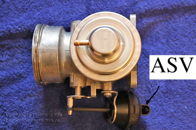

It went to the EGR or anti shudder valve. If your car runs now without it connected its the ASV which is just in front of the EGR
cud ya point me in the right direction with pic of were it goes....please
Heres a pic mate
what would be the cause of this if not connected?
engine shudders a bit when you turn it off[:cool:] us with egr deletes suffer with it
oh so not major if not connected? just i have screw in end of pipeat the minute.
no it will still work fine...is your new turbo boosting ok?
