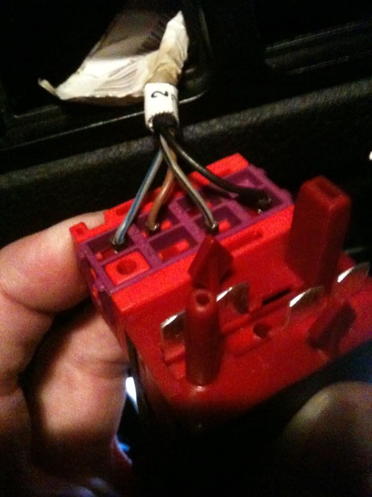

here is the the asr button with the connector in the car any ideas which wire does which so i can reaplicate as a switch?
You haven't been paying attentioin in class have you[:p]? Two of the wires are the same colour you used for your boost gauge thingummy and are used all over the inside of the car so will have the same function here.
That only leaves two which must be the switch wires,you tell me which ones you think it is and I'll tell you if you're right or not[:D].
Chris.
lol, black and grey/black are the switch?
[clap]
So what are the brown and grey/blue for?
Chris.
ground and illumination?
[clap][clap] You didn't really need me after all did you?
