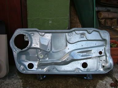

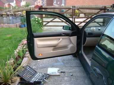

i had a bit of a nightmare coming home from BVF on Sunday.... on my way to the Meet with some of you guys, windows down.........sun going down, thought id put my passenger window up (it was messing my hair up [;)]) and CRUNCH, TWANG, yep it snapped....the regulator gave it up....but luckily in the up position so not tooooo bad.
got another panel for it today and.........
45 mins later.....
the old one is out and stripped
new one is fitted...
and everything is as it should be [:D]

if the window travels at a slower rate than the other it could well be that the regulator has a crack in it and put the window 'out of line' slightly, causing the resistance you describe....
the regulator (or clips....that actually break) is the mechanism that moves your window up and down....
its attatched to the metal door skin in the above pic (you cant see it sorry..its the other side of it !!)
what happens is that VW in their wisdom, put white plastic clips that hold the window to the regulator, and after a while (approx 3-4 yrs) they tend to crack/ break off at the very time you really dont want them to. the replacement parts have metal clips instead (but VW never recalled uk cars to fix this common prob)
the fix is a new skin with whole regulator attached(easier to fit and not as fiddly as just replacing the clips .....very fiddly and trial and error).
i'll take pics of the old clips and post tomorrow (if i can still find them!!)
you can only really tell if its the clips if you look, as it might be the motor which i heard also fails sometimes (rarely)
hope this helps[:D]

as promised the metal bit that the clips are attached to, im pointing at the place where the clip should be (gone in the bin)....this whole thing holds the window and the clip travels up and down the mechanism....they take alot of strain really [:^)]
hope it helps
