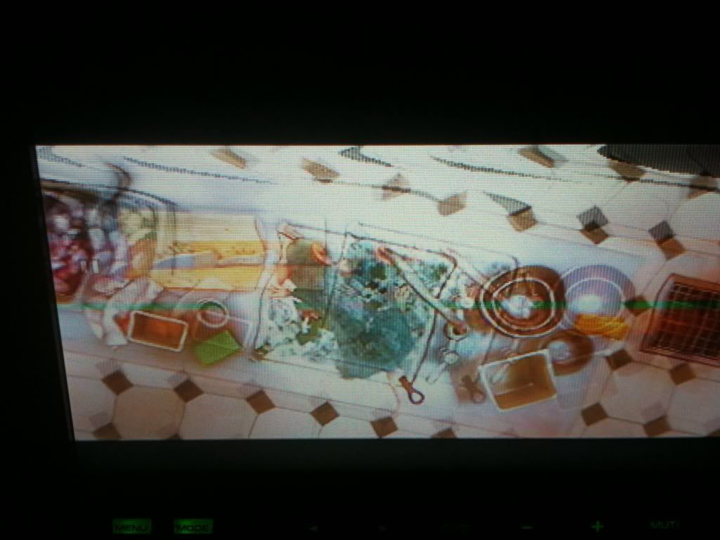

On sat I installed my new pioneer avh p4200dvd. However, occasionally when watching a DVD the picture goes distorted as pictured below. It doesn't start doing if in a middle of watching it, only when you come back watch it where you left it. Ie ignition off then on, again it only occasionally. Any ideas? The shop will exchange but I have to send it to them.
4,956 Posts
it looks like a power issue. I wired a couple of other items with the stereo loom but on the wrong side of resistor (on the red and yellow wires) going to the stereo. I have wired them between the resistor and the stereo instead it should be between the resistor and the power from the car.
