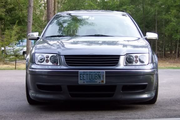

These lamps from cali are available in left and right hand drive and they will either fit the HIDs for you if you buy the hid kit at the same time as ordering the lights, i am thinking about a poss GB if we could get some numbers together (maybe) give us some feedback guys

The lamps which red-jeffers is looking at doing the GB on are not the
exact replicas which you were initially asking about. Have a look at
the eBay link and you will see the ones he is talking about.
Why would you want LHD xenons anyway?
You could get some of those of ebay.de but they won't be much good in the UK.
1,102 Posts
The lamps i would be getting would be what ever you wanted either lhd or rhd up to you and they aint the same as the ones in the pic so yes please check the ebay link 1st before saying thanks
