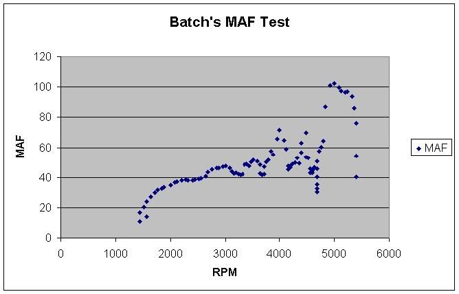

Hey guys,just need some adive on me maf. Just done the 3rd gear test using vag com. Got the following results.
My motor is a 1.8T, Revo'd, Forge DV, 76k miles, and a tiny bit down on power. Im guessing this is the problem!
Do i spend ?70 on a new one or is it worth tryin one from a breakers (cos im skint!)
345 Posts
Check this out. Imported the data i gathered from the VAG COM log into the format which the software we use in work to analyse the race car uses, then plotted a X/Y graph, same results but more detailed.
Interesting to note that peak is only 102 from a car which is suppose to be close to 180bhp. Thats a hell of a lot of power loss
