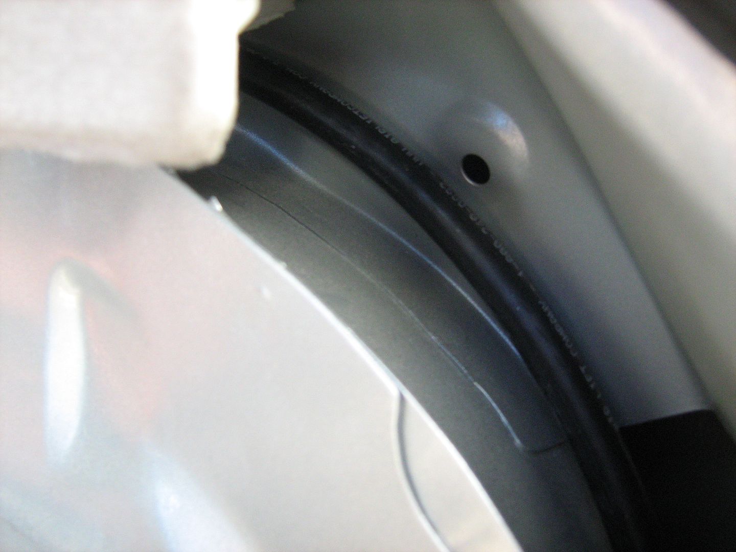

arch gap pre polo mounts
arch gap after polo topmounts

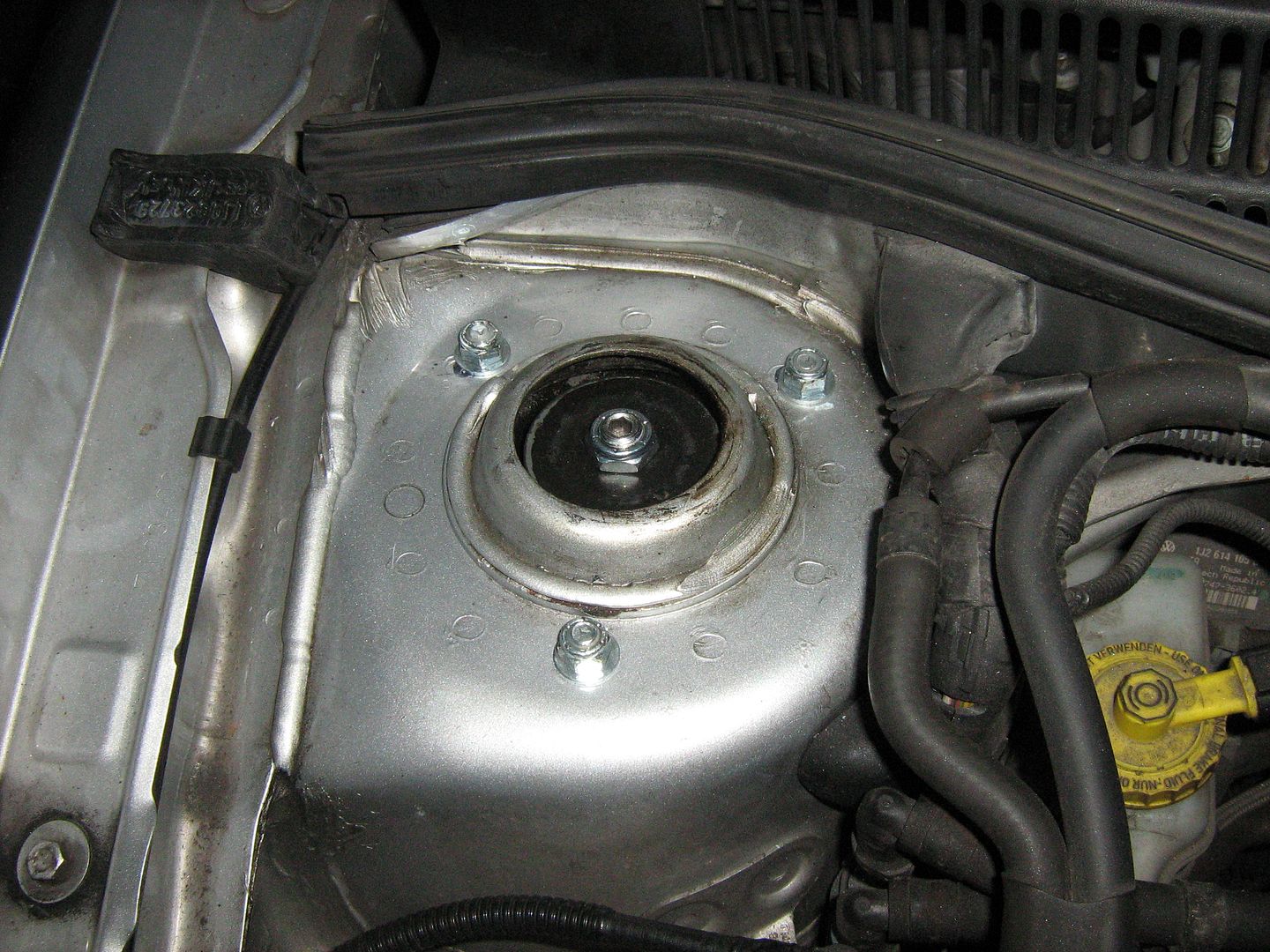

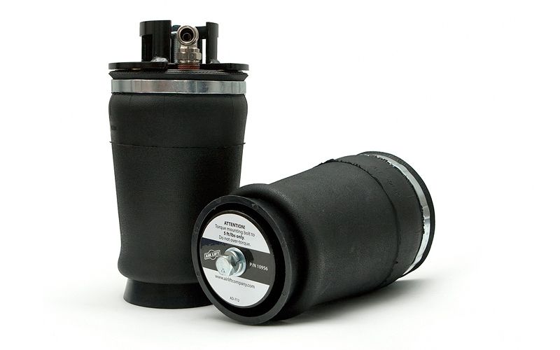

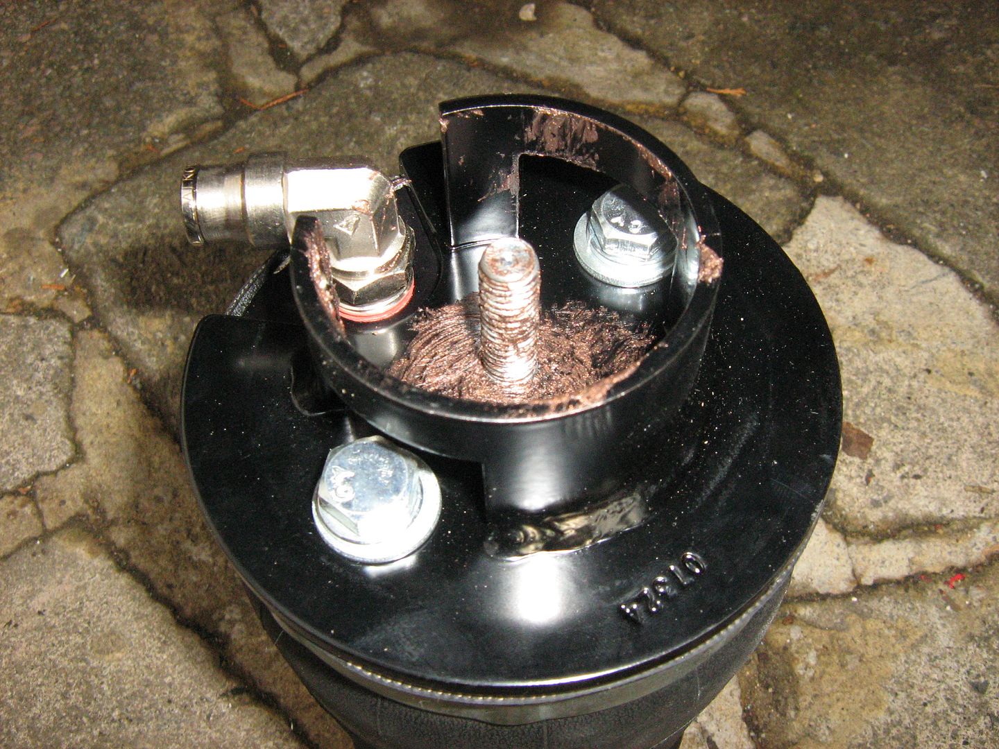

airlift front struts - notice the different top mount set up that requires drilling the strut top
airlift rear bags - rear bag platform to mount bag
fitting of the fronts
bagyard use mk4 topmounts so bolting on is just like fitting coilovers, one end slots in the hub and the top in the strut top
Airlift have their own design that uses three studs through the strut top to hold it in place

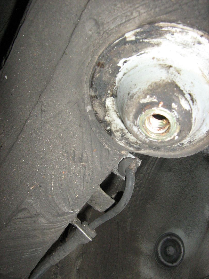

Rear bag fitment;

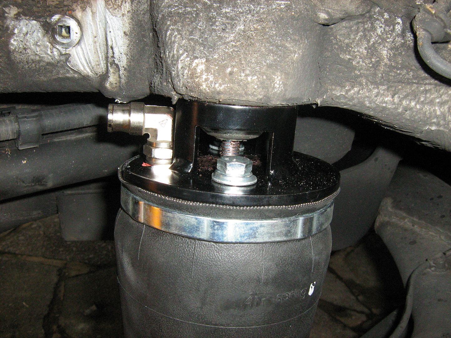

both bagyard and airlift used a rivnut through the top spring mount
bagyard rear bags screw directly into the riv nut
Airlift use a platform that bolts to the bag and screws into the rivnut
bottom of the bags both bolt on the same, same as coilover spring perches. a bolt with a large washer from the bottom through the beam into the bag.

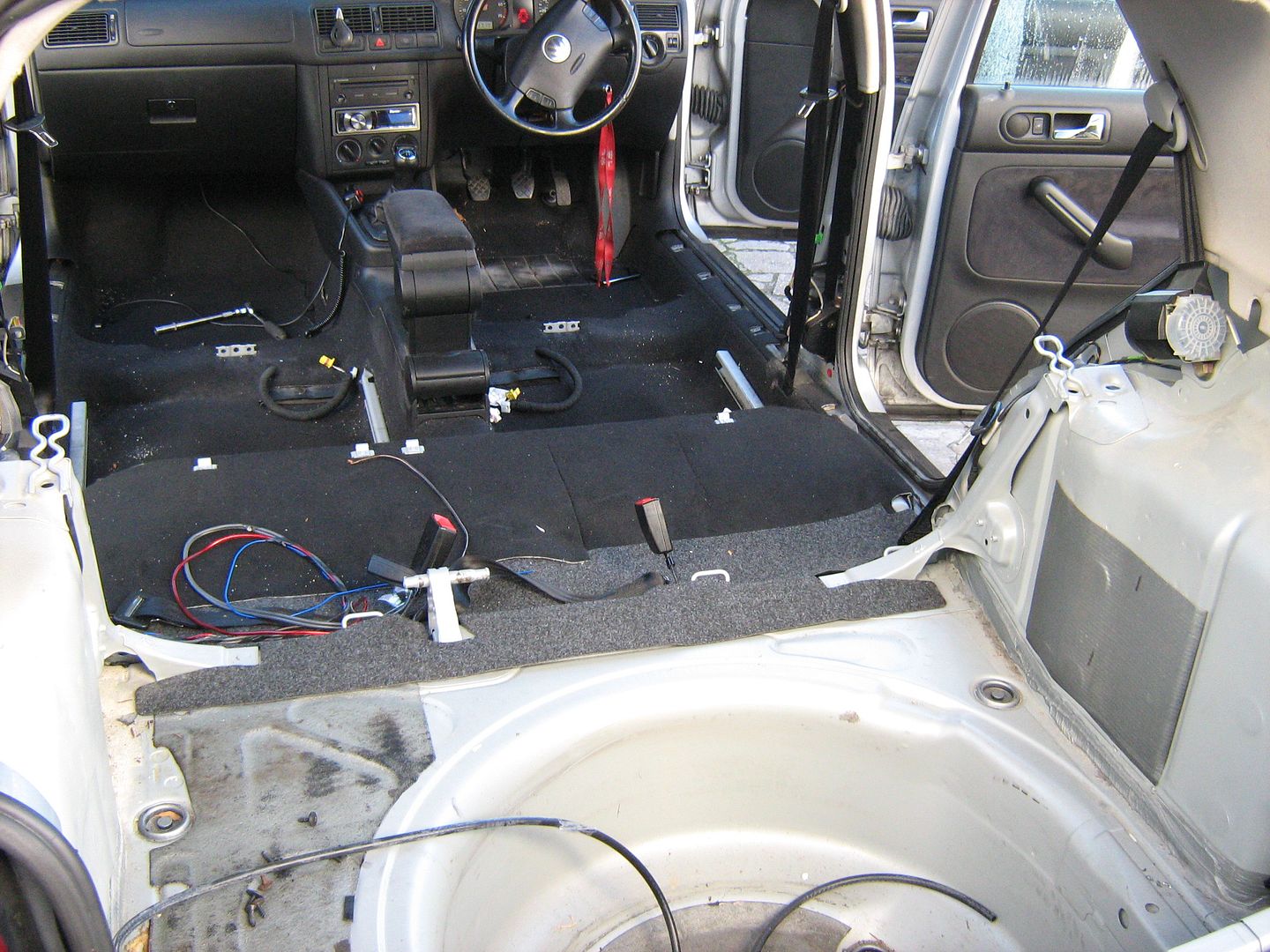

i've seen, holes drilled in the wheel well and across the rear beam and lines ziptied to the brake and fuel lines. i prefer to run the lines internally for the main part as i'm paranoid [:DD]
i always strip out the interior to make sure it's all done properly and is easier to run lines and looms

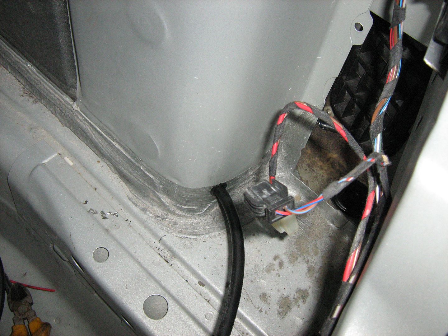

rear lines;
i run the rear lines through the rear of the rear arch
behind the filler neck on the drivers side
and behind the dirt shield both sides and into the bag
