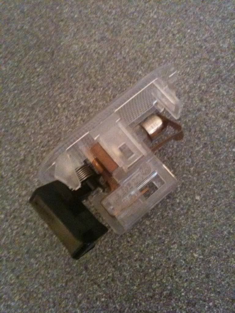

Took the glove box out today and when i went to put it back in i noticed the switch mechanism for the glove box light had come apart.
I tried to piece it back together but couldnt work out where or how the spring is positioned.
Any ideas or pics?
Heres some pics;

You'd have more chance of doing delicate brain surgery wearing boxing gloves than will ever have of puting one of those back together without one to copy.I gave up with mine ad bought a new one,only about £6.

Took about 3 hours to figure how each part needed to be compressed and the fitting order before I finally had it working again. A picture to copy is essential except the one I finally googled was blurred to half the help of these pics.
Some superglue where the 2 main halves meet to stop them coming apart does not hurt even if you gave up and bought a new one!! Be careful not to over apply though as the lens will fog.

Hi,
I want to change the bulb to led. Accidentally it fall a parts but finally I
build it thanks to the pics here.
