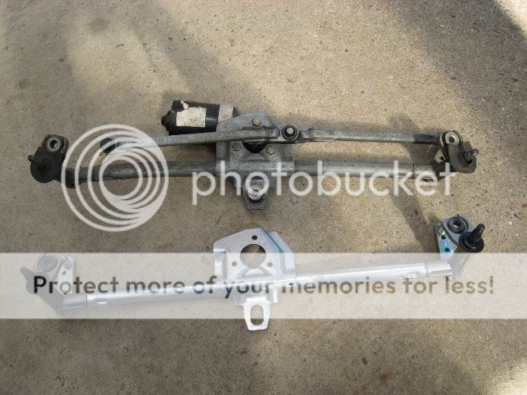

Two things are wrong.
First correct the position of the arm on the motor. It's slightly out and is causing the slight movement back up.
Once you have solved that then adjust the arms on the spindles independently to get the correct sweep.
If you read all of these posts carefully I think someone has highlighted the correct position for the motor arm fitment.
The guide absolutely states not to remove the motor arm so that this doesn't happen (by slipping the arms through the mech).
Unfortunately you had no choice swapping motors...
:Y:

Discussion Starter · #67 ·
When you strip it down, get it looking like the old mech pictured below. Motor arm parallel to the mechanisms bar.
Yours won't be like that. It will be marginally out. Fix this first and refit.
Then adjust the arms on your spindles until you get a perfect sweep.
:Y:
