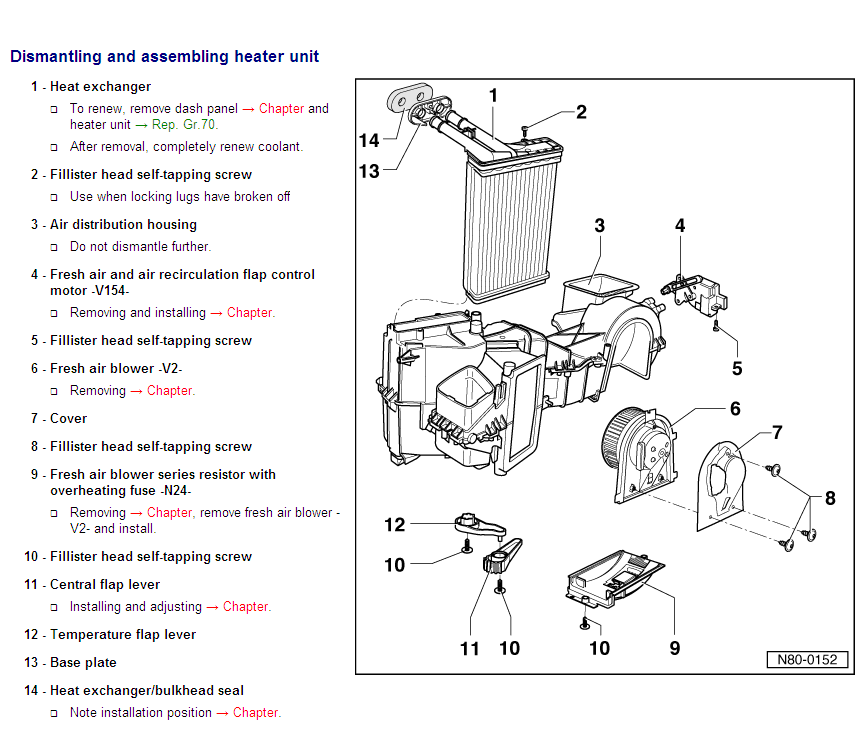

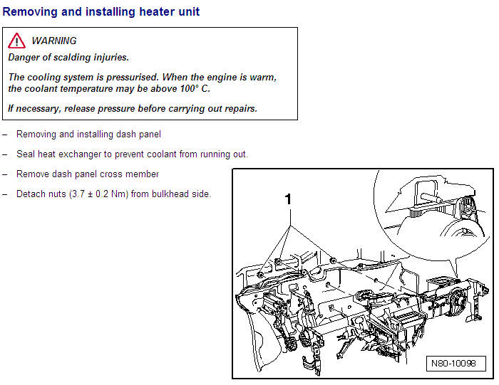

These instructions are based on the Bora but should be pretty much the same for the Golf as well [y]

Where have the instructions gone? need to change my matrix over crimbo, and could do with a pic of the matrix, as the one i have just had delivered from euro has different pipe connections to what i can see under the bonnet on the bulkhead.
#8 ·

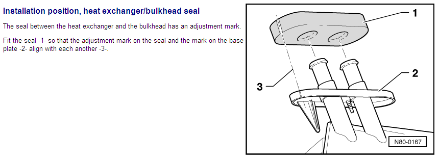

sorry to be a pita again, but i dont suppose you know whether the matrix pipes that stick through the bulkhead are the ACTUAL ones that are on the matrix, or whether they are just a fitting and the matrix sits further back. the outlets on my new matrix look like the type where you would use a jubilee clip, but the ones on the bulkhead are push fit with the wire/spring clip. hope that makes sense.

well, thanks for all your help, but i gave up, and am in the process of putting it back together now. not a job for the faint hearted i tell ya. taking the cross member out was the bit that stopped me in my tracks, because of all the wiring. once again, thanks for all your help.

you would not believe how long it took me to find this thread! started getting misty windows so replaced pollen filter... then noticed i was low on coolant but didnt put the two together until i noticed the red coolant in passenger footwell, ordered a new matrix and thought id attack it after a day at the garage...
Started about 2 1/2 hours ago and its been going well so far, bit of a pain as its cold and the gas bottles have ran out arggggg! just going to get the cross member out then hopefully rip the heater out. its certainly one of the most in depth repairs ive done this year and will keep me here for another few hours too

my matrix is all done and dusted, i must admit that i have an overwhelming sense of pride for doing it! i have some photos to upload later... thanks for this tutorial, was a life saver! a few points for anyone replacing their matrix:
1) the job is one of 'point of no return' dont start it and give up... its heavy job but is easy, only time consuming.
2) dont be too light handed, the dash is pretty solid
3) the 3 nuts holding the heater core on 2 are above the exhaust flex behind the fire proof cover and one is next to n/s shock again behind cover (there are flap cut outs but hard to see)
4)disconnect the hoses from the matrix as its difficult to get it out with them still on (i disconnected from engine first but then from matrix end)
5) don't bother trying to remove the whole heater, just undo the silver clips holding the two halfs together, there are some on front, top, below and behind so its a task in its own but easy with patience and small screwdriver
anyone who needs it doing or needs a hand i am willing to help, its a weekend job and does help having someone whos done it before with you.
