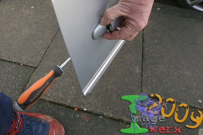

I do it like this,pulling the lock carefully and wiggling it as I slowly undo the Torx T20 screw....
