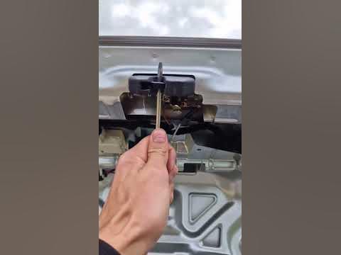

Hi guys ,wondering if anyone's got abit of advice for me and my Bora. This has been a issue prior to me owning the car and I've yet to find a solution.
Here's a video of the issue :
So when everything's connected , the boot will unlock itself if it's closed, I've tried to demonstrate this in the video. This will happen when the cars both locked and unlocked with no input at all causing all hell to break loose as you can expect. I've replaced the boot handle switch with the microswitch on the side, the boot latch, the actuator, the boot wiring loom which goes between the chassis and the boot . I've checked for continuity in all the wired all looks good from what I could tell. I've checked the ground point both on the rear passenger wheel well and the ground points underneath the dash . I have got the following fault code when scanned

Ive also done a live data test to see if the car recognises if its opening or closing which all again seems to be fine.This was a issue when i brought the car 2 years ago and since ive just had the actuator unplugged and used the key to open the boot ever since. Ill also add when i open the boot it gives the standard warning on my dash so im assuming it communicating as normal aswell
