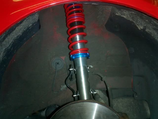

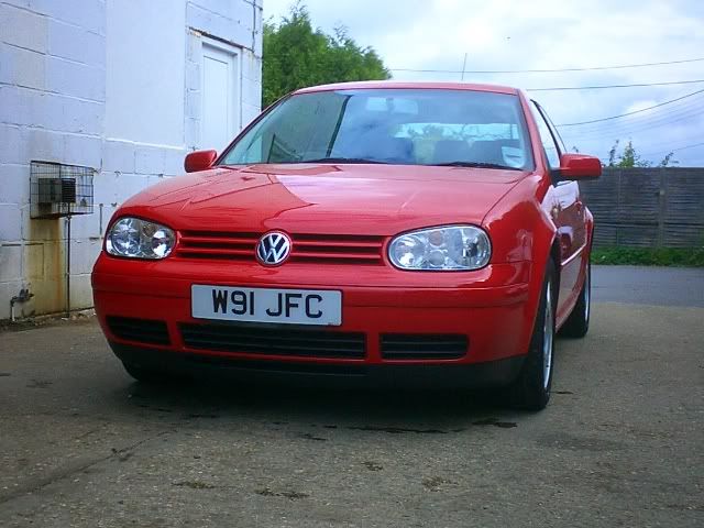

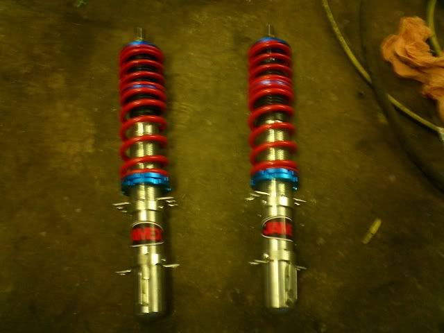

Hey everyone,
Had the Golf for about 2 months now and been wanting to post some pics but managed to resist until I had a few mods done.
I brought a set of 18" TSW Kyalami's and the new Jamex coilovers, I'm well pleased with the results. Got the lads at work to fit it all and they set the suspension about mid way so I could let it settle then maybe wind it down a bit more.
Also got an R32 bumper but its getting sprayed at the mo so that mod will have to wait.
Anyway heres some progress pics as promised....

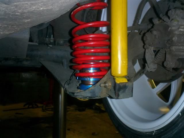

Looks great mate, but, is that how the coilovers were delivered? [:S] Don't know about Jamex but on every other brand I've seen, on the front struts, the smaller helper spring goes at the bottom, and your rear springs are almost certainly upside-down... the tighter coils usually go at the top

The front stuts were already together in the box so the tech's at work just tightened them and put them on. With the rears the adjustment plate only fits sitting at the bottom of the suspension arm and the spring fits into the adjustment plate this way up as there is a flat edge on that end and not the other so wouldn't sit flush.
I've not had a coilover kit before so not sure whats right? I'll speak to the guys at work and see what they think.
Pain in the a*se if it has to be removed and fitted again.

shiuming, thanks for pointing that out mate.
The kit didn't come with any fitting instuctions so the lads at work just fitted it as it came. I've just looked on the sight I got them from and theres a pic of the strut with the helper spring at the bottom like you said! So annoying, dont think the lads at work will be too happy when I tell them they have to do it again! Balls!
Not sure about the rears though, guess I'll just get them to try them the other way up while the cars in the workshop.
Glad I took thoses photos now or I wouldn't have had a clue, just be driving around with them fitted wrong!

Just going back to the suspension, do you think this would make it handle any differently or cause any damage?
