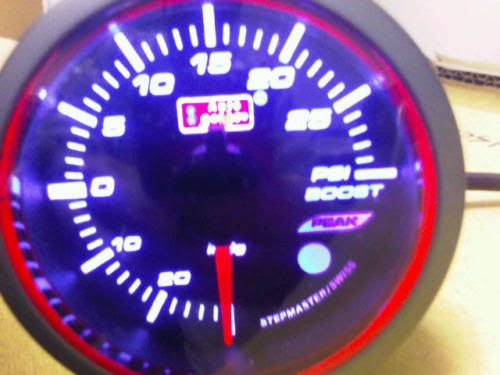

hi guys ive just received my first boost gauge from ebay fingers cross looks good and it does what it says on the tin, only probem is it is dash mounted
really need help with where the best place is to connect the power harness wires as running a wire to the battery etc just seems a mission lol but as im not to sure the last thing i want to do is blow something up lol ... diagram what came with ...
as the gauge has a smoked screen i was thinking it may be abit hard to see on sunny days so thought is it ok to wire up so it lights when ignition is turn on instead of lights or is it not wise to do ...
any help would be much appreicated cheers

Base of the relay rack above the drvers right foot.......
Black/yellow..........ignition live
Red.......................Battey +ve
Grey/blue (back of dimmer switch).......lightting dimmer
Earth stud or plain brown.....................ground
Last question,yes that will work.

Fitted the gauge on the weekend using chris's guide and what can i say works perfectly ... thanks again chris
will be moving it into the pillar soon as...not really feeling it on the dash...
