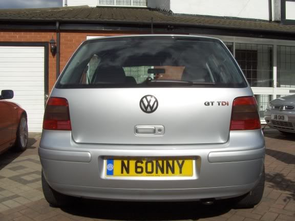

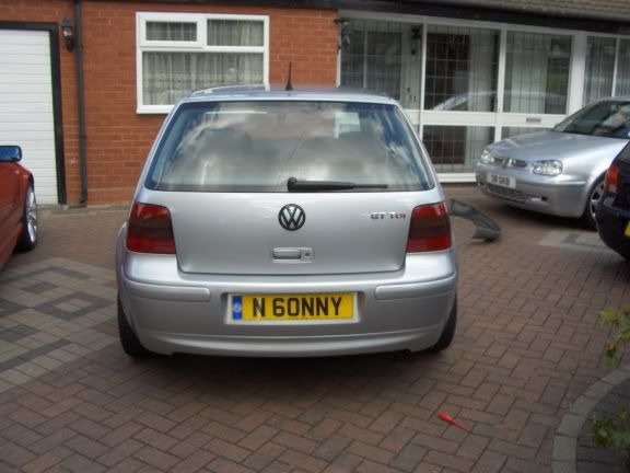

Well got bored of the standard rear valance so I decided to put on my
anni rear valance I had, I sprayed it again with halfords mixed paint
and two cans of laquer and heres the final finish... Also I started at
3 and just finished now... anyway heres the pics of before and after...
Before
Inbetween
After
This came out near enough colour match and very pleased with the finish of it also.
Comments welcome good and bad..

Thanks for the comment sem, and ye I think i may have just cracked the
art of spraying, I cant believe the finish I got with just halfords
spray cans, [:eek:] The best tip I can give anyone is have a steady hand
and dry inbetween coats and also if spraying mettalic only spray in one
continous direction as if you dont you can see it in the paint. Also
for drying use a heat gun as this hardens the paint within 10 mins and
I tested how hard it was by chucking it about in the garage just to
make sure.

No problems mate. It took me all in all 5 mins to replace the rear
valance and fit the anni one. Theres four bolts on the rear one theres
two underneath and one on each side in the rear arches.
I never used rubbing compund or the wax just two cans of light
layers of laquer and the job was spot on, I used a hot air gun which
made the paint dry very quick and the laquer cam vey shiny also.
I will be waxing it tommorow probably as I couldn't be asrsed to do it today.
