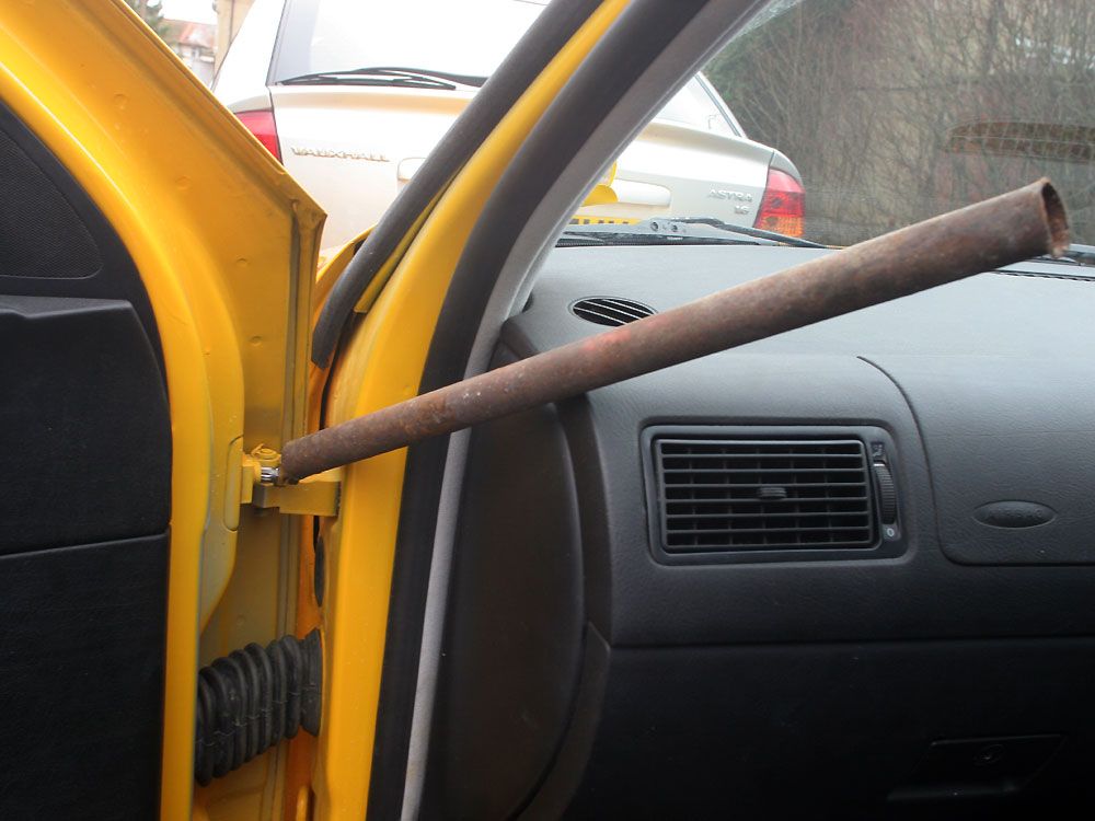

Remove the striker plate with an Emm 8 XZN or triplesquare bit (most definately NOT Torx[:(]) and loosen the door hinge bolts with an M10 XZN bit,10mm ring spanner and something for extra leverage because they will be VERY tight....
Loosen all of them then nip them up JUST tight enough so they grip but the door can be twisted by hand.It might be a good idea to put something soft and non-paint damaging under the very front as it's not as easy to get the gap right there as it is at the back of the door.Make sure the front top isn't too far out (not always obvious) as you'll get wind noise and it could leak.
